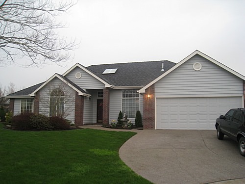

What about all those brick accent walls that I see with no weepage? What about around columns?
Jim, do you ever write up brick accents for lack of weepage and thru wall flashing?
I have no rules about those. I just evaluate them one at a time. The ones in the picture you posted look like they're all less than 33" wide. I figure the water will just weep out the sides.
In general, the narrow accents never seem to cause much trouble. On the other hand, the short, wide ones cause more than their fair share of trouble. Those 1950s-1960s houses with brick veneer halfway up the front wall all seem to have a little bit of damage behind them. At least every one that I've seen taken apart did.
