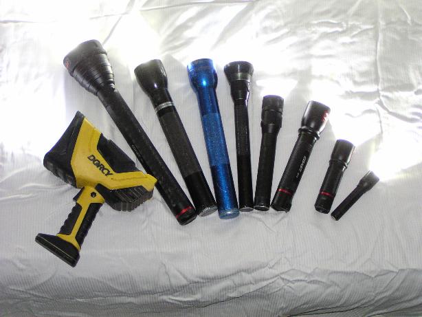

By Rick Bunzel, ACI
When I wrote my first article on flashlights in 2006, the Streamlight Ultra-Stinger won the competition over the Maglite MagCharger. Today, inspectors have many more choices of flashlights that are brighter, smaller and cost less than Maglite or an UltraStinger.
LEDs have come a long way in the last 5 years. The first LEDs were dim and cast a blue colored light. These days, LED flashlights have deep reflectors that concentrate the light into a tightly focused beam that throws long distances - as far if not further than a flashlight using a high performance bulb. Early LED flashlights used multiple LEDs to get the desired brightness but 2nd and 3rd generation LEDs have the performance to use just a single unit.
My requirements for an inspection flashlight are simple: The flashlights should be rechargeable, preferably with a 12-volt charger, brightness greater than 200 Lumens, comfortable fit in my tool belt, and neutral light color. For this review, I was able to get several new LED flashlights and I found LED conversions for the Maglite MagCharger and the Ultra-Stinger. I made an exception on the rechargeable requirement for Coast flashlights as they had some high performance lights and a monster flashlight that, on paper, outperformed any of the other lights.
I used the lights on inspections to provide real life testing conditions. I tried to use the lights for at least two weeks each. For my test pictures, I set up my tripod 60 feet from the side of my house. I set my camera on "night scene" mode and focused the center of the beam on my target.
All pricing is from internet sources, but most is from Amazon.
L to R: Dorcy Spotlight, Coast HP21, Mag Charger, LED Maglite, Streamlight UltraStinger, Streamlight DS LED,
Coast HP14, Coast HP7, LED Lenser P5R. Not Shown: Dorcy Cree Xre. Photo by author
