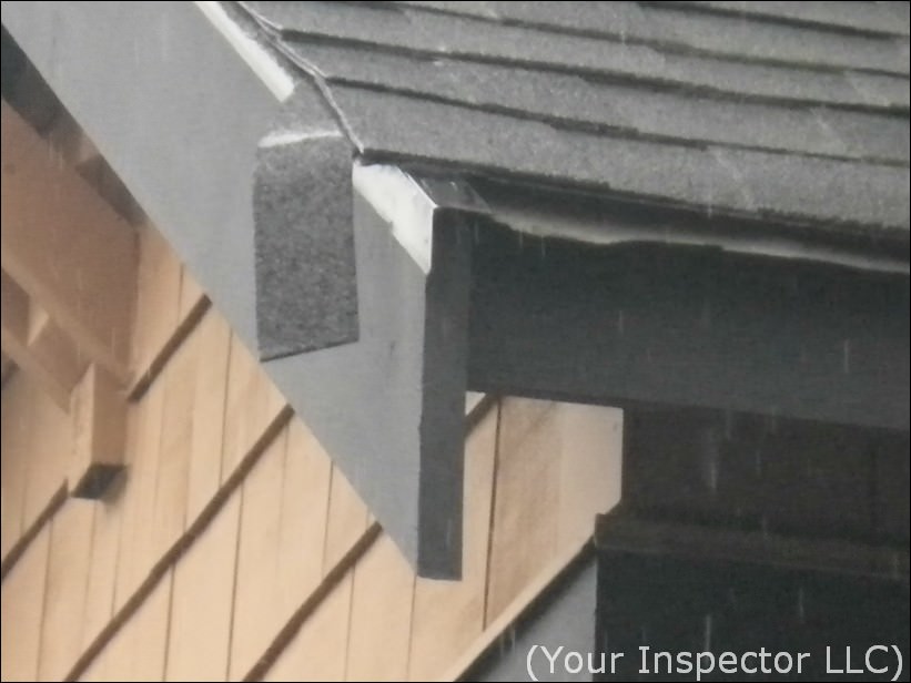

Quote: Originally posted by hausdok
Quote: Originally posted by Inspectorjoe
Why do the rake boards extend past the fascia?
....... and the rake boards on the lower roof are even a little short because they don't completely conceal the ends of the gutters, which is the way they are usually cut here.
I don't think I've ever seen it done that way. What's the reason for it? I'd think it would allow at least a little water running off the roof to miss the gutter and at the same time, set up conditions conducive to rot between the end of the gutter and the inside of the rake board extension.
Around here, the gutter typically extends past the rake board a bit, or at the very least is flush with it.

[#9] Posted: 04/05/2012 - 09:34:46 AM
Reply with Quote
Yep,
You're right. It does cause the ends of the rakes to rot. Most roofers here cut a couple really narrow strips of asphalt and install them shingle fashion on top of that. Some, not many, cover them with bits of metal. Lots of times, if they aren't tacked down or adhered with mastic, those pieces blow off like the strip shown in the photo below.
As I said, it's a design choice. It hides those ugly gutter ends and folks seem to prefer that to what you've got in that photo.
