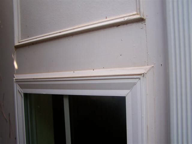

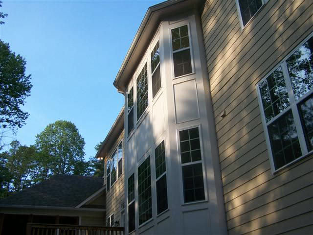

Image Insert:
42.72 KB
Image Insert:
82.24 KB
All the windows at the plywood sided portion of the rear of this home are unflashed (see top photo) while all the rest of the windows installed where there is lap siding have observable head flashing.
The windows installed over plywood have only a small bead of caulk and a coat of paint to prevent water intrusion.
I'm gonna get a battle from Pulte on this one, because every home in the subd. is built this way.
So -- Do they need to flash these windows? Is caulk enough?

Look at page # 5
If they are not installed to the mfgrs. specs when they leak the homeowners insurance will not pay to fix things.
