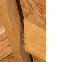

Just saw that this morning in a new home.
Image Insert:
40.51 KB

What would you report about the splice in the ridge board? It may be acting as a mechanical connection between the opposing rafters, but it will also be transferring some load to it's endbearing - right?. Not to mention the less than ideal placement of the splice.
