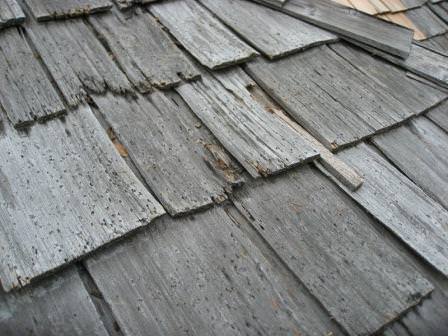

These are photos from my afternoon gig. The shakes are cracked, uplifted, exceedingly soft, and they've had organic material--replete with tiny red flowers--growing within them. I told the realtor--who's ethical--that the roof(which is alleged to be thirty-five years old)was pretty well shot. She said the seller had a roofer check out the shakes before the house was listed and that he said it was just fine.
I asked if fine meant that it wasn't leaking presently, or if it would last another five years, and she didn't know.
I only see one or two shake roofs a year and wondered what youse guys thought of this thing. I told my client my experience with wood roofs was limited and to call someone I trust for a more precise assessment.
But really, look at this thing. Isn't it pretty much toast? I was able to scrape damp, wicked-soft fibers off of several shingles with my fingernail.

It's shot. However, the roof on my smokehouse makes that roof look new and it doesn't leak.

Ditto, shot. Call for immediate replacement.

I look a lot of shake roofs and they can look pretty good from a distance or with a quick glance. It's when you slow down and really take some time to evaluate that you'll get a better idea of what's going on. Either a very good pair of binoculars and/or getting up to the gutters on the ladder at various locations will tell you what you need to know.
Moss/algae certainly are bad news for wood not not necessarily a death sentence. Splitting, softness, warpage, poor overlap, decay all are excellent indicators. From your pics I'd agree with you. Don't let the contractor who says its ok deter you from your opinion. My guess is that he doesn't want the job and is blowing off the client by saying roof is ok. It is simply not reasonable to expect someone to buy a home with a roof in that condition and as you probably know, shake roofs cost A LOT ON MONEY.
Many people consider a leak as one that's dripping through their ceiling. To me a leak is one thats gotten through the roof covering. If it's getting to the decking it's a leak.

Thanks for the replies. The condition of the roof pretty much spoke for itself. Then again, I'm not one of those frightening people who think I know everything.

I really can't see much of the shake through all that algae and moss but what I do see is very little curl and very little splitting.
The edges of the shake that are visible are thick and clean--no rot or deterioration.
35 years is a lot, but what if this stuff is some of that precious, true old-growth heart wood stuff? 50 years is expected life on that stuff, no?
I think a proper cleaning and treatment of that roof would amaze everyone.

My eyes probably aren't as good as yours, but under all of that moss I think I'm seeing some butt rot - a lot of it. John, scratching off a little bit of shake surface doesn't mean a whole lot. They're generally pretty soft, even when they're dry. What's important is how much rot you've got. Were the top outside edges of all of those shakes a sharp corner or were the center of the butts rotting in a semi-circular pattern.
Randy, I agree, some parts of the country probably can get 50 years, but I doubt they can get that in Kentucky.

I don't understand what you mean vis a vis a semi-circular pattern, Mike, but the edges were rough and ragged, and there were countless splits.

These are thin. And these are rotting. Look at the edges.

1) I can't tell a whole about a shake roof from a photo, but I'm going to come down more on the side of Randy than "shot".
Depending on a wide range of variables, that roof could have a fair amount of life left in it. Maybe some butt rot, but when did butt rot start meaning the roof is totally shot? Butt rot is an indicator, but only one indicator.
Same w/lichen; not good, but it doesn't mean it's dead either. Clean it off, then see what it looks like.
Those valleys look like copper; if there are similar fine flashing details throughout, that by itself would make me think the roof had some life.
The ability to scrape moist wood fibers off w/a fingernail doesn't necessarily damn the thing either.
I'll let those on site to hold sway, but honestly, it looks like it needs cleaning & some repair, and it could last a heck of a long time.

You have to split it before it gets back on-topic. What you could do, is start another thread about smokehouses and then those who've posted could come on here, copy what they've posted so far, delete it, and re-post it to your smokehouse thread.
The problem with the roof is the cost of getting it properly cleaned and then the rotten shakes removed and replaced. If the roof has 20 to 25% butt rot, the cost is prohibitive. It makes more sense to install a new roof at that point because you'll spend that much or more every successive year until you finally bite the bullet and replace the cover.
If a shake roof is properly maintained from day one, it will last indefinitely - well, at least as long as they continue to make shakes. However, it's rare that I find a roof that's been properly maintained. Most folks around here think that 'maintenance' means paying some jackass with a pressure-washer $200 to $250 bucks to go up there, remove a few years service life from the cover by using high pressure, punch a bunch of holes clean through the cover and the felts, and then spray some rust-colored dye onto the roof to make it look great from the ground. When I inspect those, I typically find more damage than if they'd left the cover alone. I frequently have to recommend that freshly "maintained" shake roofs be torn off and replaced.
Proper shake maintenance means getting up on the roof every year, finding all broken, missing, rotting shakes, removing them and installing new ones. When you remove one rotten butt, you also have to remove the two that are side-by-side beneath it, because the rot will have spread into those. Proper cleaning means either mechanically cleaning the cover with a soft-bristled broom or brush and a blower, then treating all algae, moss, and lichen with a chemical to kill it and rinsing it off the cover. Proper sealing means using a real shake oil preservative, not dye.
Around here, we have roof cleaning companies and real roof maintenance companies. The roof cleaning dudes, with few exceptions, have the collective IQ of a grape. If I had my way, there'd be a hunting season wherein home inspector could bag their limit of these horrible creatures every year before they do too much damage. Most are a pimple on the butt of society.
The true roof maintenance companies are different. They'll use high volume low pressure methods to clean the cover. It takes longer but it doesn't damage the shakes. They'll use real shake preservative. They guaranty their work and longevity of the cover, based on the condition of the cover when they're first called to look at it. They'll tell the homeowner when cost of maintenance over the next few years is going to exceed what it will cost to replace the entire cover now. They're expensive - about $1500 to properly bring back the cover over a 1200 sf bungalow; $2500 to $3000 to do the cover on a 3600 sf home.
I know of a home in Seattle that had the original shake cover from 1957 when I inspected it in 2001. It was in excellent condition and had been lovingly maintained by its homeowner, who'd built the house originally. He'd been using reputable shake maintenance companies for nearly half a century. He figured that he spent about $900 to a $1000 annually on maintenance in the late 1990's but it had been less years before. Cost probably equalled cost to have completely replaced that roof 3 times. In this climate, if he hadn't done the maintenance, he probably would have had to replace it 3 times anyway over that period, but he'd never had to deal with the inconvenience or mess or roof leaks or mess (and there is one hell of a mess when they tear off and replace a shake roof) of a full tear off and replacement.
John's roof has been sorely neglected to have that much fungal growth on it. The cover will be rife with incipient rot spore. Cleaning it and trying to fix it piecemeal at this point will be like peeing into a strong wind.
My opinion - worth the price charged, I suppose.

Quote: Originally posted by randynavarro
Alright, I'm going to disagree. Somebody's got to do it.
I agree.
While it's possible that the roof in John's pictures is shot, there's nothing in the pictures to indicate that.
John, in the future, when you inspect a shake roof, the area to focus on is the condition of the portion of the shake that's visible in the keyway -- the space between the shakes. The thinnest exposed portion of each shake is the part at the keyway. That's where a shake roof fails. When you can see felt there, it's a serious problem.
Moss, lichen, minor splitting and, yes, even butt rot, are minor distractions. Look at the keyways.
- Jim Katen, Oregon

The keyways were actually in pretty good condition. The splits, I suppose, are what seemed the most egregious shortcomings.
Thanks for the help, everyone. I'll be better at this next time.
As for cleaning and maintaining a shake roof? I'd be very surprised if anyone in my area would have the first clue.
