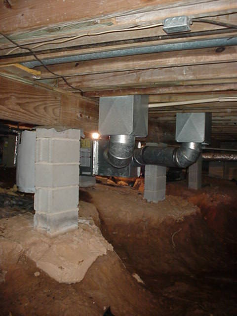

Some one wanted some more workspace in the walk in crawlspace.

If he doesn't reinforce that dirt, he's going to end up with less work space.

Philip I've seen a lot worse undercutting and have seen some that was really old, but have never seen signs of soil failure at those undercuts. Maybe it's the stability and strength of Ga red clay. At one undercut job, that was accomplished with equipment, the worst erosion of soil base was occuring on the outside of the foundation wall, where wrong-way site sloping was carving out beside the footing every time it rained. The house was under foreclosure, and the buyer who hired me found it on an internet list of "distressed properties". I don't think he bought it, but he seemed to be a trouble magnet. I followed him to his dwelling to get paid, and there he showed me burglar damage that his landlord wouldn't fix, and then he showed me the pistol he kept in his pocket due to the unsavory 'hood he lived in. Got my check and never seen him since.
Erby, I have scratched my head a lot to figure out how one might "reinforce" or support that kind of mistake, and decided the only practical correction would be to start at the new level of cut, install spot piers with posts and beams to pick up whatever loads there are.

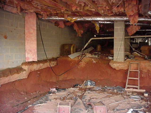

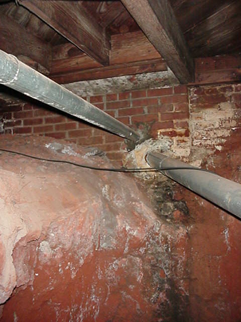

Couldn't stand it. See below.

Cpl more.
