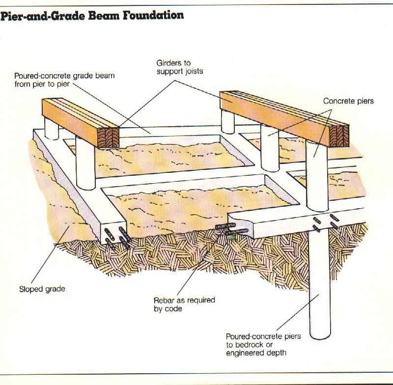

I have never heard it called a grade beam on piers/caissons, but for the sake of this discussion let's call it that. The piers can be usually from 6 to 12 feet on center. The bearing (footprint)size of the piers varies also with each structure and the depth is usually not reliant on frost depth but how far it is to stable soil. The paper filler is exactly what Mike said. I spoke with the current building inspector today, he could not find any record of it being an engineered foundation. This foundation system may have been just a bad guess on how to construct it as the subfloors vary several inches in elevation. My clients decided against buying the home because of the movement evident and also the moisture issues that I have not mentioned. I built a home a few years ago that on one end the soil was expansive and the end was on soil that consolidation was a factor. It was to be built on a crawlspace but due to the varying conditions and a favorable soil strata at about seven feet it was constructed on a full basement for only slightly more than the engineerd foundation would have cost and also doubled the size of the home.

Here's a sketch of what I was referring to - they're used where unstabile/expansive soils are common.

If a home was built on expansive soil using the sketch design there would most likely be some sort of void placed under the concrete beams. Another design to deal with some expansive soils is to overexcavate, as in the case I am familiar with, three feet and then compact class 6 roadbase back to the original elevation. A convential foundation was then constructed
