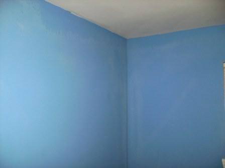

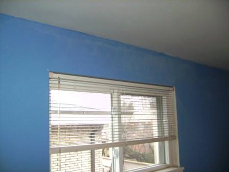

Well the mold issue was not as bad as the homeowner was telling me on the phone. The pictures below are of the the walls in the master bedroom. The white efflorescence looking stains look like water condensing on the interior wall surfaces. I did not find elevated moisture readings in the GWB. No black mold in the house. The attic was totally dry, well ventilated and no signs of mold or elevated moisture levels.
This house was a wreck when I looked at it five years ago. Since then; the windows have been updated, new oil furnace installed, new electric water heater, new roof, new gutters. The only structural moisture issues I found were a plugged dryer vent, the bathroom fan venting into the attic which was fixed by the roofer on Thursday, low air flow from the bathroom fan, and the main floor bathroom surround and floor rotting out and absorbing moisture.
These folks keep the furnace down at 40 degrees. They only turned it up when we went through a recent cold snap, to maybe 50 degrees and then turned it back down. I think when the interior temperature was raised the humidity level went up and then when they turned it back down the water condensed on the inside walls???
I convinced then to run their furnace more and heat the house at about 60 degrees. I will also have them repair the noted defects and improve the attic (low) and wall (probably zero) insulation.

I agree, sounds like you nailed it. the walls of their house are acting like a cold coke bottle and all of that moisture they are creating is condensing at the coldest parts of those walls, the plates and corners. I often see the same thing in closed off sections of houses where elderly folks have been living alone for years. Hope you told them that the money they're saving by keeping the heat so low is probably going to cost them later in condensation issues.
