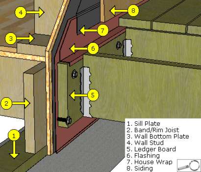

Couple of Diagrams that should help.
Click to View
25.1 KB
Click to View
12.97 KB

Quote: Originally posted by hausdok
Click to View
12.97 KB
Mike,
Why does this pict show you can use screws to attach the ledger? What type of screws (versus bolts)?

Quote: Originally posted by Jerry Simon
Mike,
Hi Jerry,
I don't know what was in the mind of the person that drew that diagram. If memory serves, I got it by going to the APA site and then following some links there to another site called "Build A Better Home" or something like that. It's possible that "screws" refers to some of the new self-drilling super-strong ledger screws that some manufacturers brought onto the market a few years ago; those are installed with an impact driver, have a self-drilling head that eliminates the need for pilot holes and they're supposed to be stronger than lag bolts and have better holding power.
For those of you that came to inspections from the electrical, HVAC, plumbing or other trades, if you've never actually "built" anything, you might spend some time on this site. You can get a free downloadable deck construction guide there or simply click on the "Building 101" tab and you'll learn a lot.
Since T1-11 is structural sheathing, some folks don't like to cut through it to install a ledger. That makes sense because, if you cut it in the wrong place, you end up leaving the bottom edge unsupported. If one cuts through this stuff to install a ledger it's necessary to make the cut below the bottom of the sole plate, preferably a couple of inches below the top of the rim, so the sheathing can be tied into the rim and maintain strength against racking.
Some folks that install on the face of the T1-11 will insist that the slots will allow it to drain without trapping water. It seems to work most of the time but not all the time and it's those 'not all of the time' situations that we have to be concerned with so I think spacers behind that ledger would have been an excellent idea.
Either of those diagrams will work with T1-11 siding by cutting away a section of the T1-11 in order to install a ledger; just ensure that if you use the second drawing - the one with the back flashing only - that you use spacers so that water can't get trapped behind the ledger and ensure that your flashing is against the studs and behind the WRB behind the T11 and extends at least six inches up the face of the studs. This means you need to free the bottom of the panel along the entire rim and once the flashing is in it needs to be re-secured through the flashings. If you omit the spacers like in th first photo, make sure that you use a head flashing on top of the ledger, along with the back flashing, to keep water out.
For spacers, you can dink around with coating little pieces of wood with a preservative or cutting blocks from pressure-treated wood or trying to line up a bunch of flat washers, but a better solution is the Deck2Wall Spacer. These things are cool; you pre-drill pilot holes in the ledger and rim, line up the spacers on the backside and screw them to the ledger. Then it's easy for one guy working alone to attach the ledger without the frustration of dinking around with blocks and washers.
Jeremy, I see T1-11 covering rims all the time without joints. It all depends on whether the builder planned it out carefully first and purchased longer 9 or 10 ft. panels that can extend over the rim without the need to install Z-flashings.

Quote: I see T1-11 covering rims all the time without joints. It all depends on whether the builder planned it out carefully first and purchased longer 9 or 10 ft. panels that can extend over the rim without the need to install Z-flashings.
I'm talking about regular half inch ext. sheath behind the siding. More times than not, I see a filler applied to the band instead of longer material. I'm curious if everyone else is seeing simular method. New construction of course.

OK, well now I understand. We see it done all the time because it's part of building seismic resistant structures.

Having just used them in a report, I happen to know that the diagrams came from the APA's document on Flashing details for Walls & Windows.
