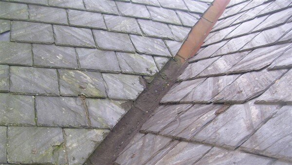

	<img alt="slateroof.jpg.eb215efae5bdd58ba42064778bd7b899.jpg" class="ipsImage ipsImage_thumbnailed" data-fileid="2058" data-ratio="50.00" style="height:auto;" width="600" data-src="https://www.inspectorsjournal.com/uploads/monthly_2024_12/slateroof.jpg.eb215efae5bdd58ba42064778bd7b899.jpg" src="https://www.inspectorsjournal.com/applications/core/interface/js/spacer.png" />
</p>
<p>
	In my experience, many folks are getting incomplete, incorrect or in some cases, intentionally misleading advice about their slate roofs. This usually leads to either non-professional and temporary repairs, costly unnecessary repairs or replacement of a roof that still has many decades of remaining life.  I've found many unfairly condemned slate roofs that could likely last another century and sometimes even more. As a home inspector, I feel it's important to accurately and objectively inform my clients about their roof's type, condition, immediate repairs needed and future maintenance. Here's a few of the most important concerns:
</p>
<p>
	All slate roofs, no matter the type or age, require regular repairs. As the roof gets older, the frequency or amount of the repairs usually increases.  It's most important that homeowners find the right contractor with the right knowledge, skills and tools to make those repairs.
</p>
