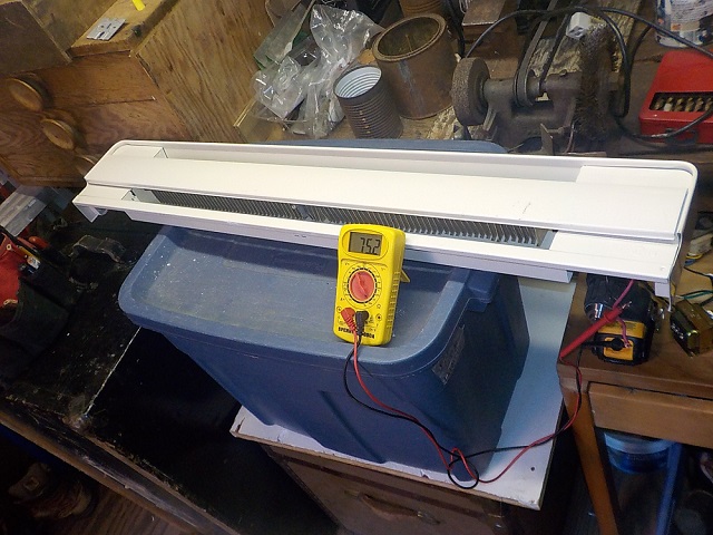

John Kogel Posted July 18, 2017 Report Share Posted July 18, 2017 I suspect the steam is just in the name. You wouldn't want steam in there with no place to go. You can check something like that with your DMM. Measure the resistance between the prongs of the plug, Make sure the switch is on. Almost zero or zero resistance, it's shorted. Infinite resistance, it's burned out. Quote Link to comment Share on other sites More sharing options...

Jim Katen Posted July 18, 2017 Report Share Posted July 18, 2017 20 hours ago, John Kogel said: I suspect the steam is just in the name. You wouldn't want steam in there with no place to go. You can check something like that with your DMM. Measure the resistance between the prongs of the plug, Make sure the switch is on. Almost zero or zero resistance, it's shorted. Infinite resistance, it's burned out. I don't know if it makes steam or not, but if it did, the steam would go into the radiator the same as it would in a regular steam system. There'd be an air vent that would let out the air and snap shut when the steam hit it. I've never had luck identifying heating elements with a DMM. They always read zero for me - even when they're fine. What am I missing? Quote Link to comment Share on other sites More sharing options...
John Kogel Posted July 19, 2017 Report Share Posted July 19, 2017 (edited) With no expansion tank, if designed to make steam, I don't think it would meet safety standards of even the 1930's but that's just a guess. If there's a PRV it would need a discharge pipe or it would blast steam into the living space. There's resistance in an electric heating element. You'd need to have your meter on the lower scale.. This 750 Watt heater has an R of 75 ohms. Edited July 19, 2017 by John Kogel added pic to prove I'm right this one time. ;>) Quote Link to comment Share on other sites More sharing options...

John Kogel Posted July 19, 2017 Report Share Posted July 19, 2017 Thanks, John, and Jim, you are correct, it does appear to make steam with an immersion-type heating coil. Production started in 1932 and the ad is from 1948. Quote Link to comment Share on other sites More sharing options...
