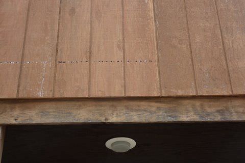

RickSab Posted July 9, 2010 Report Share Posted July 9, 2010 I don't get a lot of wood siding like this in my area so I need the collective brain trusts help. This house was remodeled probably pre 1990. Many of the siding panels have a series of holes that are repeated at consistent spacing. It looks like the feed roller punctured the panel as it ran through the production line. Is this a known problem with sheet goods siding? Any guess as to the brand? Thanks in advance. Click to Enlarge 22.16 KB Quote Link to comment Share on other sites More sharing options...
kurt Posted July 9, 2010 Report Share Posted July 9, 2010 It looks like woodpecker damage. Bugs get in voids in the plywood, and the 'peckers find them. I see this on almost every plywood siding job someplace. This one is more extensive than most. Quote Link to comment Share on other sites More sharing options...
Scottpat Posted July 9, 2010 Report Share Posted July 9, 2010 I tend to agree with Kurt on good ole Woody looking for a snack. It does however look like something was attached to the siding on the left side of the photo, old caulk line? Quote Link to comment Share on other sites More sharing options...
Les Posted July 9, 2010 Report Share Posted July 9, 2010 Rick, yes it is a common problem/defect. We see it on almost a daily basis. Many different mfgs. not so common in the recently mfg'd stuff as they now fill the second ply before lamination. at least that is what GP does. Quote Link to comment Share on other sites More sharing options...
RickSab Posted July 9, 2010 Author Report Share Posted July 9, 2010 My first thought was wood peckers,but the holes always lined up perfectly and repeated on some sheets at the exact same spacing. Always horizontal patterns about 30 inches apart. Quote Link to comment Share on other sites More sharing options...

Jim Katen Posted July 10, 2010 Report Share Posted July 10, 2010 My first thought was wood peckers,but the holes always lined up perfectly and repeated on some sheets at the exact same spacing. Always horizontal patterns about 30 inches apart. The woodpecker is punching holes in a perfectly straight line because the gap in the middle layer of veneer is in a perfectly straight line. That's where the bugs go. Around here, they'd be mason bees. They crawl into those long, narrow tunnels formed by the gap in the veneer, and they lay their eggs. They place an egg, then a plug with some food, another egg, another plug with some food, and so on. The eggs hatch into larvae, who eat the food and then pupate. Now here's the interesting part, the pupae emerge as adult bees in reverse order. So the last egg laid emerges, leaving room for her sister, who emerges next & so on. Except that sometimes the woodpeckers find them first. - Jim Katen, Oregon Quote Link to comment Share on other sites More sharing options...
John Kogel Posted July 10, 2010 Report Share Posted July 10, 2010 My first thought was wood peckers, but the holes always lined up perfectly and repeated on some sheets at the exact same spacing. Always horizontal patterns about 30 inches apart. The inner veneer strips are laid that way, crossways with a little gap between strips, then the top sheet is laid over that, forming little tubes that bugs like. Quote Link to comment Share on other sites More sharing options...
RickSab Posted July 11, 2010 Author Report Share Posted July 11, 2010 Thanks for all the help. I've seen the holes woodpeckers have left in rafters and trim when they go after the carpenter bees. They were never so uniform. One of the things I love about this place is you get to learn something new every day. Quote Link to comment Share on other sites More sharing options...
