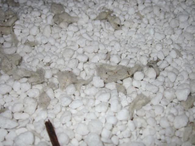

Jim Morrison Posted July 10, 2010 Report Share Posted July 10, 2010 I've never seen this material before. Can one of you tell me what it is? This 110 year old house had UFFI in the walls and this stuff in the attic floor. I think it was likely installed within the last 10 years or so. The little puff balls were almost the same consistency as a Cheeto. Thanks in advance, Jimmy Quote Link to comment Share on other sites More sharing options...
Terence McCann Posted July 10, 2010 Report Share Posted July 10, 2010 Any pic Jim? Quote Link to comment Share on other sites More sharing options...
Jim Morrison Posted July 10, 2010 Author Report Share Posted July 10, 2010 Let me try again: Click to Enlarge 48.33 KB Quote Link to comment Share on other sites More sharing options...
Rob Amaral Posted July 10, 2010 Report Share Posted July 10, 2010 ....man... that looks like cotton, Jim... "Meffa"? Quote Link to comment Share on other sites More sharing options...
Rob Amaral Posted July 10, 2010 Report Share Posted July 10, 2010 wait a min... Cheeto-like ... ? No idea... weird.. I'd burn it to see how it would react ... (at home) Quote Link to comment Share on other sites More sharing options...
kurt Posted July 10, 2010 Report Share Posted July 10, 2010 Popped perlite? Quote Link to comment Share on other sites More sharing options...
Brandon Whitmore Posted July 10, 2010 Report Share Posted July 10, 2010 My guess was gonna be perlite-- so I second that one. Quote Link to comment Share on other sites More sharing options...
Jim Katen Posted July 11, 2010 Report Share Posted July 11, 2010 The coarsest perlite you can get is about 1/4" in diameter. If the stuff is that big or smaller, I'll bet it's perlite. If it's larger, I have no idea. Quote Link to comment Share on other sites More sharing options...

Jim Morrison Posted July 11, 2010 Author Report Share Posted July 11, 2010 The pieces were as large as about 5/8 inch I'd guess, but it definitely wasn't UFFI. Rob- Not Meffa, but Hamilton. Jimmy Quote Link to comment Share on other sites More sharing options...

kurt Posted July 11, 2010 Report Share Posted July 11, 2010 Perlite, taken off Wikipedia....... Click to Enlarge 8.82 KB Maybe it's Fresh Mozzarella Cheetos........ Quote Link to comment Share on other sites More sharing options...
Bill Kibbel Posted July 11, 2010 Report Share Posted July 11, 2010 It's perlite. Expanded perlite is graded into different sizes and is separated by screening. The stuff that's 1/4" or less is typically available as an additive for gardening soil and light-weight concrete. There is one grade, that's used almost exclusively for thermal insulation, that can be screened to as large as 1". 5/8" chunks is not unusual for expanded perlite. Quote Link to comment Share on other sites More sharing options...
