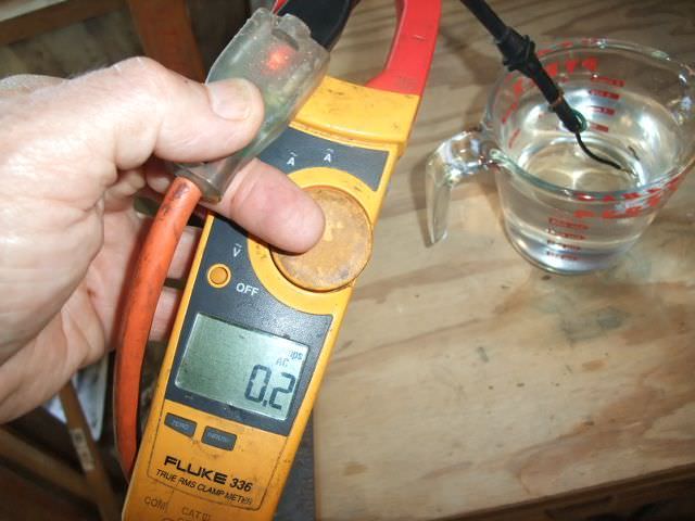

Marc Posted August 1, 2010 Author Report Share Posted August 1, 2010 Where I live, I can't get a measurable amount of current to flow through a glass of tap water. Can you? Please note: I am not saying it's safe to mix water & electricity. My only point is that, at least in my area, tap water doesn't contain enough ions to conduct measurable current. Add a little salt - such as is present on most peoples' skin - and the conductivity goes way up. - Jim Katen, Oregon The battery voltage in a common multimeter evidently won't move enough current through the water to deflect the meter, but try the experiment again with the voltage available from an electrical outlet. I did this a few decades ago. Connect a light bulb on a socket to an outlet plug and interrupt the closed circuit by cutting the wire open at one point. Place the two cut ends in your glass of water and see what happens. If you don't get illumination, check the amperage with your multimeter. Let us know. Maybe you'll prove your point. Marc Quote Link to comment Share on other sites More sharing options...

Jim Katen Posted August 1, 2010 Report Share Posted August 1, 2010 Where I live, I can't get a measurable amount of current to flow through a glass of tap water. Can you? Please note: I am not saying it's safe to mix water & electricity. My only point is that, at least in my area, tap water doesn't contain enough ions to conduct measurable current. Add a little salt - such as is present on most peoples' skin - and the conductivity goes way up. - Jim Katen, Oregon The battery voltage in a common multimeter evidently won't move enough current through the water to deflect the meter, but try the experiment again with the voltage available from an electrical outlet. I did this a few decades ago. Connect a light bulb on a socket to an outlet plug and interrupt the closed circuit by cutting the wire open at one point. Place the two cut ends in your glass of water and see what happens. If you don't get illumination, check the amperage with your multimeter. Let us know. Maybe you'll prove your point. Marc Look at the picture again, Marc. It shows the two leads from a circuit breaker immersed in water. The multi-meter is clamped around one of the leads. It shows no flow of current at its lowest setting. - Jim Katen, Oregon Quote Link to comment Share on other sites More sharing options...
Jim Katen Posted August 1, 2010 Report Share Posted August 1, 2010 would the water conductivity change if the water went through a water softener first? thats a big bag of salt....interesting...lots of folks have them around here... As I understand it, a water softener removes calcium & magnesium ions from the water and replaces them with sodium ions. I don't know if sodium ions will cause water to conduct electricity better than calcium & magnesium ions. I suspect that, with regard to conducting, any old ion will do and that hard water will be more conductive both before and after it's been softened. - Jim Katen, Oregon Quote Link to comment Share on other sites More sharing options...
Marc Posted August 1, 2010 Author Report Share Posted August 1, 2010 Where I live, I can't get a measurable amount of current to flow through a glass of tap water. Can you? Please note: I am not saying it's safe to mix water & electricity. My only point is that, at least in my area, tap water doesn't contain enough ions to conduct measurable current. Add a little salt - such as is present on most peoples' skin - and the conductivity goes way up. - Jim Katen, Oregon Nope. Click to Enlarge 49.93 KB Click to Enlarge 47.43 KB But I lay claim to the prettier cuticle![] Marc Check this out. Quote Link to comment Share on other sites More sharing options...
Jim Katen Posted August 1, 2010 Report Share Posted August 1, 2010 Nope. Your tester was clamped around just one of the wires, not both, right? But I lay claim to the prettier cuticle![] Woof! Ain't neither of us going to get a job as a hand model. Quote Link to comment Share on other sites More sharing options...
Marc Posted August 1, 2010 Author Report Share Posted August 1, 2010 Nope. Your tester was clamped around just one of the wires, not both, right? Right. Why? Marc Quote Link to comment Share on other sites More sharing options...
Jim Katen Posted August 1, 2010 Report Share Posted August 1, 2010 Nope. Your tester was clamped around just one of the wires, not both, right? Right. Why? Marc I just couldn't see from the picture. - Jim Katen, Oregon Quote Link to comment Share on other sites More sharing options...
stubrooks Posted August 20, 2010 Report Share Posted August 20, 2010 I don't think you're going to find, a clamp-on ammeter than will accurately measure in a range of 5 milliamps. The picture above shows the meter is reading 200 milliamps with an open circuit. Not real accurate in the low range. That's 0.2A to 0.005A. Take a guess why GF interrupters are designed to trip in the range of 5-6mA? Quote Link to comment Share on other sites More sharing options...
Jim Katen Posted August 20, 2010 Report Share Posted August 20, 2010 I don't think you're going to find, a clamp-on ammeter than will accurately measure in a range of 5 milliamps. The picture above shows the meter is reading 200 milliamps with an open circuit. Not real accurate in the low range. That's 0.2A to 0.005A. Take a guess why GF interrupters are designed to trip in the range of 5-6mA? Click to Enlarge 33.48 KB Quote Link to comment Share on other sites More sharing options...
