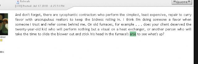

GrantJones Posted July 22, 2010 Author Report Share Posted July 22, 2010 Referral discussion: Click to Enlarge 28.35 KB Not trying to start anything, I just want to know if it's just me. Really trying to learn from you guys here... Quote Link to comment Share on other sites More sharing options...

Ben H Posted July 22, 2010 Report Share Posted July 22, 2010 Grant, I fear you misunderstood John. I think he was referring to HVAC guys that he could refer to his clients about repairs, etc...Not that (he) or (we) should, would, or could dismantle furnaces and such. To answer your question, I do not go any further than the front panel of any HVAC equipment. But I may be the one that is misunderstanding the statement. Quote Link to comment Share on other sites More sharing options...
GrantJones Posted July 22, 2010 Author Report Share Posted July 22, 2010 Grant, I fear you misunderstood John. I think he was referring to HVAC guys that he could refer to his clients about repairs, etc...Not that (he) or (we) should, would, or could dismantle furnaces and such. To answer your question, I do not go any further than the front panel of any HVAC equipment. But I may be the one that is misunderstanding the statement. I hope so, but if this 20 year old HVAC repairman is only doing a visual...what's he been hired to do? Quote Link to comment Share on other sites More sharing options...
GrantJones Posted July 22, 2010 Author Report Share Posted July 22, 2010 And by the way, thanks for so far validating I'm in line with what you're doing. I probably did just misunderstand the post... John, can you clear this up? Quote Link to comment Share on other sites More sharing options...

Bain Posted July 22, 2010 Report Share Posted July 22, 2010 The referenced post had to do with referrals, and I was talking about SOMEBODY else--specifically an HVAC tech--performing the cliched "further assessment" on a suspect furnace. I said that having a buyer pay an incompetent tech to perform a visual was a waste of time, but that there were people I refer who I know will take the time to pull the blower, stick their heads inside the furnace and see what's up with the heat exchanger. Having said that, I DO occasionally pull a blower myself, but not typically in a crawlspace or similarly yucko environment where you need a tarp or piece of cardboard to prevent the blower from getting muddy, etc. This isn't something anyone should do unless they've been shown how by a competent HVAC person. It's relatively simple--you (typically) just remove a couple of screws and the wiring harness, and slide the blower out on its tracks. Doing so goes way beyond the Standards, but, if you're curious like me, it's kind of fun and only takes ten minutes or so. Interestingly, a lot of cracks are discovered, but I can also often see where a heat exchanger has failed because soot is visible escaping from the crimps. Be aware that an exchanger doesn't have to have a physical crack to be considered, "failed." Like Terry said, customers delight in knowing someone has gone beyond the call to look out for them. That's why I unfailingly take a photo from the highest portion of a roof and include it in my report. The annotation says something like, "Nothing revelatory, here. I just wanted you to know that I earned my outrageous fee." Quote Link to comment Share on other sites More sharing options...

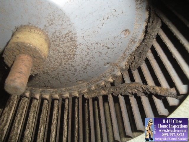

Erby Posted July 23, 2010 Report Share Posted July 23, 2010 I don't bother reminding them about my "outrageous fee" but I usually also include a picture or two from the high point of the roof at the beginning of the roofing section. I don't pull blower fans but I do usually wiggle it and stick my camera in to get a picture of the fan blades to see what condition they're in. Find some interesting stuff riding the fan blades. Click to Enlarge 41.63 KB Click to Enlarge 70.01 KB - Quote Link to comment Share on other sites More sharing options...
