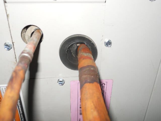

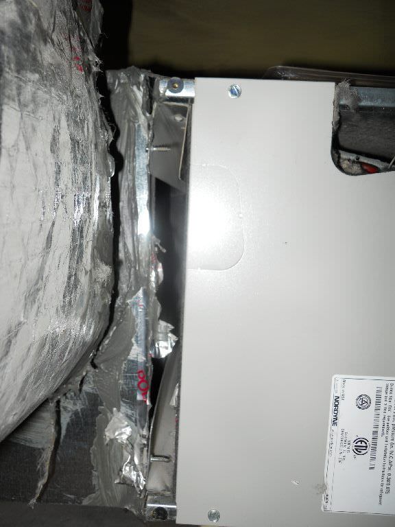

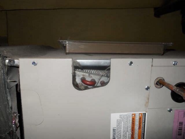

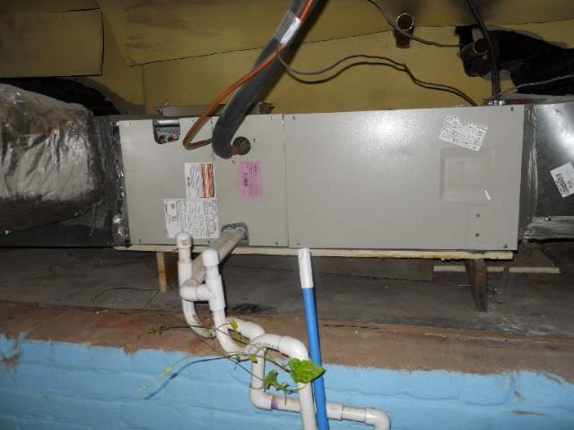

mgbinspect Posted August 14, 2010 Author Report Share Posted August 14, 2010 [:-bigeyes Click to Enlarge 43.29 KB Click to Enlarge 27.12 KB [:-banghea [:-gnasher [:-banghea [:-gnasher [:-banghea Click to Enlarge 61.94 KB Click to Enlarge 26.21 KB [:-banghea Quote Link to comment Share on other sites More sharing options...
Marc Posted August 14, 2010 Report Share Posted August 14, 2010 That unit is likely losing about a third to half of it's tonnage via those air leaks. When I see this, I inquire of the seller about the most recent electric bill. Marc Quote Link to comment Share on other sites More sharing options...
mgbinspect Posted August 14, 2010 Author Report Share Posted August 14, 2010 That unit is likely losing about a third to half of it's tonnage via those air leaks. When I see this, I inquire of the seller about the most recent electric bill. Marc Marc, Words cannot adequately describe my feelings when I behold a mess like this. It's the kind of stuff that makes ripping the yellow pages book in half easy. What ever happened to tradesmen? Quote Link to comment Share on other sites More sharing options...
