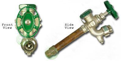

hausdok Posted August 15, 2010 Report Share Posted August 15, 2010 Before I start googling it, I guess I'll ask here; does anyone know why water should be pouring out of the vacuum breaker cap on a frost-free bib when a hose is connected and it's turned on? I'm guessing that something is jammed inside but I've never run into this before. Anyone ever run into this? ONE TEAM - ONE FIGHT!!! Mike Quote Link to comment Share on other sites More sharing options...
Marc Posted August 15, 2010 Report Share Posted August 15, 2010 I see that problem fairly often. Those devices don't seem to last very long. The disc get jammed or blocked by debris, as you suggested and doesn't extend all the way out where it blocks the vent holes. You're not short on water pressure, are you? Marc Quote Link to comment Share on other sites More sharing options...

mgbinspect Posted August 15, 2010 Report Share Posted August 15, 2010 Isn't it actually MORE than simply a frost-free feature? I thought they were equally, if not more, in place as an anti-backflow preventor to prevent water being pulled back into the domestic water or city system. Or, are those two different beasts? If they are different, anyone have pictures showing the difference? Quote Link to comment Share on other sites More sharing options...

Greg Booth Posted August 15, 2010 Report Share Posted August 15, 2010 Double duty-frost and backflow prevention. I also see this frequently, and agree that it's due to debris. It is also the bane of folks winterizing, because the backflow preventer will not permit pumping in antifreeze. Quote Link to comment Share on other sites More sharing options...
Marc Posted August 15, 2010 Report Share Posted August 15, 2010 Isn't it actually MORE than simply a frost-free feature? I thought they were equally, if not more, in place as an anti-backflow preventor to prevent water being pulled back into the domestic water or city system. Or, are those two different beasts? If they are different, anyone have pictures showing the difference? Two different beasts. Vacuum break device for hose bibs: Click to Enlarge 13.09 KB Freeze proof hose bib: Click to Enlarge 13.77 KB Marc Quote Link to comment Share on other sites More sharing options...

mgbinspect Posted August 15, 2010 Report Share Posted August 15, 2010 Isn't it actually MORE than simply a frost-free feature? I thought they were equally, if not more, in place as an anti-backflow preventor to prevent water being pulled back into the domestic water or city system. Or, are those two different beasts? If they are different, anyone have pictures showing the difference? Two different beasts. Vacuum break device for hose bibs: Click to Enlarge 13.09 KB Freeze proof hose bib: Click to Enlarge 13.77 KB Marc Thanks Marc! Now that you show a photograph of each, I have seen them both. I must admit, though, that I thought they were merely different versions of the same thing. I did not realize that one was freeze proof only. [:-graduat Quote Link to comment Share on other sites More sharing options...
Inspectorjoe Posted August 16, 2010 Report Share Posted August 16, 2010 Isn't it actually MORE than simply a frost-free feature? I thought they were equally, if not more, in place as an anti-backflow preventor to prevent water being pulled back into the domestic water or city system. Or, are those two different beasts? If they are different, anyone have pictures showing the difference? Two different beasts. Vacuum break device for hose bibs: Click to Enlarge 13.09 KB Freeze proof hose bib: Click to Enlarge 13.77 KB Marc Thanks Marc! Now that you show a photograph of each, I have seen them both. I must admit, though, that I thought they were merely different versions of the same thing. I did not realize that one was freeze proof only. [:-graduat No, it's not freeze proof only. That frost free hose bib has a vacuum breaker built into it: Click to Enlarge 10.22 KB The brass colored device is to retrofit an existing hose bib with back flow prevention. A nearby township requires they be installed on non vac-breaker equipped bibs before they'll issue a Certificate of Occupancy. On thing I've noticed with the screw-on type is that they very often don't allow a frost free bib to drain. You need to push the little plastic piece inside the outlet to the side for the water to drain out. I demonstrate this to the buyer, but it's unlikely they remember it when it's needed. Quote Link to comment Share on other sites More sharing options...
