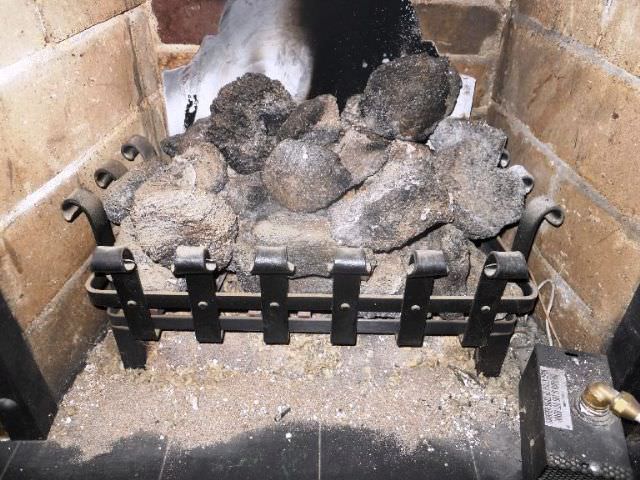

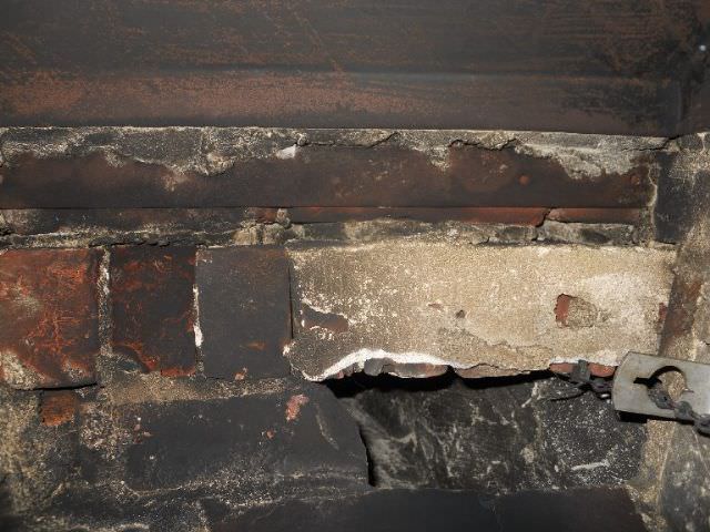

mgbinspect Posted August 19, 2010 Report Share Posted August 19, 2010 Below is one of three natural gas fire coal basket replicas in a completely renovated 1910 rowhouse - truly amazing ideas and work. Click to Enlarge 85.84 KB Anyone familiar with THIS PARTICULAR coal basket set? I removed some of the pieces trying to expose the burners, but it was obvious I'd have to completely unload it to figure it out - no attached docs. It appears to be an older vented unit. The throat on all these fireplaces was sealed off with brick. A portion was removed to permit some venting. My initial thought is that all of the bricks blocking the throat should be removed for good measure. Click to Enlarge 68.86 KB The flues have, at some point, been relined with terra cotta tiles. I doubt terra cotta flues were original to the structure. And, a chimney top damper has been added. Click to Enlarge 63.05 KB Thoughts on venting and CO? Any boilerplate you guys normally throw in the report that may inspire me to modify my own is greatly appreciated. As always, thanks in advance. Class is in session.... Mike Quote Link to comment Share on other sites More sharing options...
hausdok Posted August 20, 2010 Report Share Posted August 20, 2010 It's been 37 years but that "coal" kind of looks like the coke we used to burn in the 55 gallon drums in the middle of our shop in the winter to stay warm in the Turner & Seymour foundry in Torrington, CT back in 1973. Why would you need a larger flue for a gas fireplace. If they've got adequate draw with what they've got? Making it wider isn't necessarily going to help, especially if they are relying on venturi effect to increase draw through a narrower opening at the base of that throat. Plus some of those top of the flue dampers draw very strongly too. ONE TEAM - ONE FIGHT!!! Mike Quote Link to comment Share on other sites More sharing options...
mgbinspect Posted August 20, 2010 Author Report Share Posted August 20, 2010 It's been 37 years but that "coal" kind of looks like the coke we used to burn in the 55 gallon drums in the middle of our shop in the winter to stay warm in the Turner & Seymour foundry in Torrington, CT back in 1973. Why would you need a larger flue for a gas fireplace. If they've got adequate draw with what they've got? Making it wider isn't necessarily going to help, especially if they are relying on venturi effect to increase draw through a narrower opening at the base of that throat. Plus some of those top of the flue dampers draw very strongly too. ONE TEAM - ONE FIGHT!!! Mike That's what I wanted to hear. I've been thinking that even vented gas log can have the damper closed to the point that a damper lock meters. Isn't that right? Or, is a damper lock a failsafe device? It's a shame that the bricks they removed are on one side of the throat instead of dead center over the coal set. I'm not crazy about that. But, my main concern was CO, so maybe it's enough to emphasize CO detectors. Probable note: "The lower level fireplaces are shallow - originally designed for coal. The throats of the fireplaces were, at some point, sealed off with brick. Some of those bricks were apparently removed to provide ventilation for the natural gas burning vented coal basket sets. Since these modifications are most likely not to any set of standards, it is strongly recommended that CO detectors be installed in the rooms with these gas units. Modifications to the throats may be required if the detectors report. Also, remember that these gas units are considered vented, and the damper MUST be open when they are in use." Quote Link to comment Share on other sites More sharing options...

Hearthman Posted August 20, 2010 Report Share Posted August 20, 2010 A gas logset must be listed to ANSI Z21.60 or Z21.84 for vented logs and Z21.11.2 for ventfree. Any appliance without an identifiable rating plate identifying the mfr., model, serial #, listing, test lab, BTU input rating fuel type, and operating instructions should be treated as an unlisted appliance and recommend stop use and replace with a listed unit. With the throat blocked off in this Fp, that would force this to be a listed ventfree. If it is not listed as a ventfree, then it should be shutdown and removed. Open hearth fireplaces must be constructed to the code. If you undertake repairs or modifications, those changes must comply with the current code. There is no standard or code that allows the reduction of a throat to match the sizing charts in the gas code. Those GAMA tables were developed for CatI gas appliances. An open hearth must meet those code requirements for sizing because they exhaust on avg. 400-600cfm while burning. Choking off the throat can result in spillage of flue gases including CO but it also drastically raises temps of the breast and facing. FYI, most coal burner gas sets come from the UK and only a few a listed but they are testing more. One of the problems with these early sets was simply the difference in pipe threads. Any gas burner or logset that reaches from one sidewall to the other is too large for that Fp and should be removed. You need several inches of free space for good air circulation. HTH, Quote Link to comment Share on other sites More sharing options...
Marc Posted August 20, 2010 Report Share Posted August 20, 2010 A gas logset must be listed to ANSI Z21.60 or Z21.84 for vented logs and Z21.11.2 for ventfree. Any appliance without an identifiable rating plate identifying the mfr., model, serial #, listing, test lab, BTU input rating fuel type, and operating instructions should be treated as an unlisted appliance and recommend stop use and replace with a listed unit. With the throat blocked off in this Fp, that would force this to be a listed ventfree. If it is not listed as a ventfree, then it should be shutdown and removed. Open hearth fireplaces must be constructed to the code. If you undertake repairs or modifications, those changes must comply with the current code. There is no standard or code that allows the reduction of a throat to match the sizing charts in the gas code. Those GAMA tables were developed for CatI gas appliances. An open hearth must meet those code requirements for sizing because they exhaust on avg. 400-600cfm while burning. Choking off the throat can result in spillage of flue gases including CO but it also drastically raises temps of the breast and facing. FYI, most coal burner gas sets come from the UK and only a few a listed but they are testing more. One of the problems with these early sets was simply the difference in pipe threads. Any gas burner or logset that reaches from one sidewall to the other is too large for that Fp and should be removed. You need several inches of free space for good air circulation. HTH, Bob's post has got me thinking of a new dimension for home inspections. I'm aware of all the controversy involving home inspectors quoting code when the inspection contract states that the inspection rendered is not a code inspection. That's another issue. But what about ANSI, GAMA and lots of other standards. Is there any question about the appropriateness of us using them? Maybe we should be keeping a library of standards as well as code books. There's some really top notch inspectors on this forum but I don't see standards being quoted much. Marc Quote Link to comment Share on other sites More sharing options...
