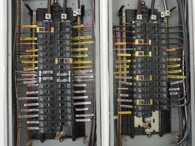

mgbinspect Posted August 20, 2010 Report Share Posted August 20, 2010 Well, this is a first for me: I'm looking at two, side by side, Siemens 200 AMP breaker panels in the garage. There is no main breaker in either panel. Click to Enlarge 72.55 KB Behind these panels on the outside wall are two side by side Automatic Transfer Switch Boxes. Click to Enlarge 40.72 KB Yet, there is no generator or apparent hookup for a future generator. There isn't even the slightest indication there ever was a generator. Each of the transfer switch boxes had covers hinged at the top and secured at the bottom with thumb-screws that were rusted fast to the box. I suppose they could have lifted up to reveal a generator plug in each box, but I've never seen a transfer switch built in to the hookup. The panels are setup to be subs, with segregated neutals and grounds. Even if the Transfer switch boxes to have plugs, what about main disconnects? I'm stumped. Any insights? Quote Link to comment Share on other sites More sharing options...
Marc Posted August 20, 2010 Report Share Posted August 20, 2010 How about a photo? Inside and outside. Marc Quote Link to comment Share on other sites More sharing options...
mgbinspect Posted August 20, 2010 Author Report Share Posted August 20, 2010 In a bit. still in the field. Quote Link to comment Share on other sites More sharing options...
Brandon Whitmore Posted August 20, 2010 Report Share Posted August 20, 2010 Sounds like there has to be a meter main somewhere? If the panels are not wired as sub- panels, then something is hoakey. Quote Link to comment Share on other sites More sharing options...
mgbinspect Posted August 20, 2010 Author Report Share Posted August 20, 2010 OK, pictures and additional notes have been added to the original post. Class is in session... I can only guess that had I been able to get one of the covers up, I'd have found a generator hook up. But, that means that every circuit in this entire 6400 square foot home is generator ready. Quote Link to comment Share on other sites More sharing options...

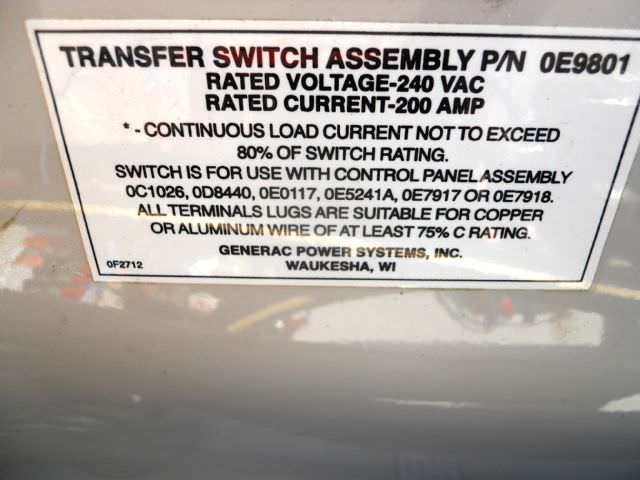

Richard Moore Posted August 20, 2010 Report Share Posted August 20, 2010 It looks like they are "Generac 200 Amp Outdoor Automatic Transfer Switch w/ Service Entrance". See http://www.everygenerator.com/Generac-R ... N1030.html . I can't find a photo of the interior, but my guess is that the "w /Service Entrance" bit means that there is a service disconnect under that cover. I think the generator (it would be a big one) would be hard wired from a remote location (was there a pit somewhere?). In other words I doubt that there will be a socket under the cover. I'd call out the rusted screws as a safety issue and suggest the client gets more info on the set-up from the seller and/or a sparky. Quote Link to comment Share on other sites More sharing options...
Marc Posted August 20, 2010 Report Share Posted August 20, 2010 I'm guessing that the enclosure in the 2nd photo which is situated to the left of the transfer switches has the main disconnect or disconnects within it. That would explain the separated neutral/grounds in the panelboards. I'm also guessing that this installation is meant to rely on portable generators which are wheeled up to the transfer switches in times of need. Any size power plant up to the transfer switch rating could be attached. Loads which are too large for the generator capacity to serve are switched off at the panel breakers. As for why 2 transfer switches are present instead of one, it's easier to get more power plant capacity to the site if you can accomodate two units. The presence of two panels makes that easily done. You could also hook up a single power plant to both transfer switches simultaneously if you wished, as long as you adjusted the connected load to match the KW and KVA capacity of the plant. Marc Quote Link to comment Share on other sites More sharing options...

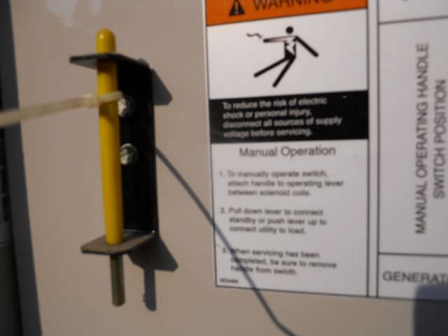

Richard Moore Posted August 20, 2010 Report Share Posted August 20, 2010 A bit more for you to peruse... If you go to http://www.generac.com/Service/ManualSearch/ and enter RTSE200A3CSA in the search box, it will take you to a pdf manual. There are some photos of what is behind the front cover. It seems there is a "Utility Service Disconnect" there...and no socket. Quote Link to comment Share on other sites More sharing options...

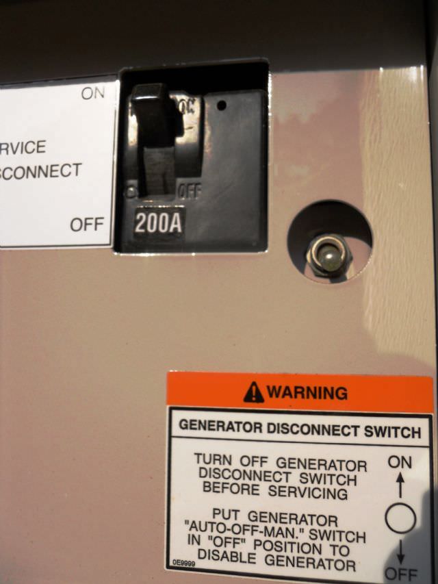

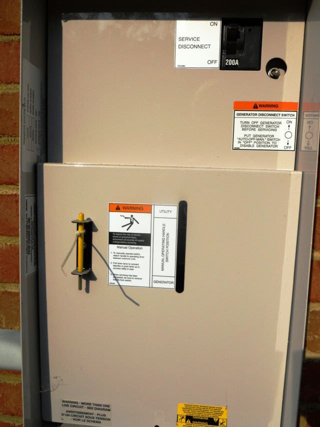

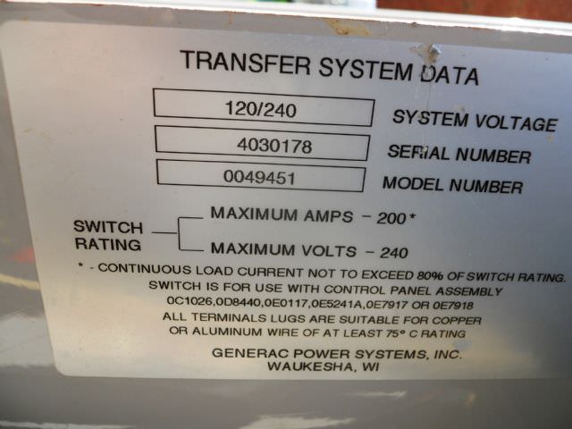

mgbinspect Posted August 21, 2010 Author Report Share Posted August 21, 2010 I made it out there and got the boxes opened. Click to Enlarge 60.8 KB There are main disconnect switches inside each. They are identical. A toggle switch to turn off the AT feature is beside the main breaker. Click to Enlarge 59.5 KB Click to Enlarge 99.23 KB Click to Enlarge 77.13 KB Here are the the most significant labels: Click to Enlarge 31.96 KB Click to Enlarge 26.19 KB Click to Enlarge 44.35 KB Click to Enlarge 53.84 KB I drove the perimeter of the property peering into the woods for any signs of a generator and scanned the outside of the home for any propane lines that might have been abandoned or roughed in for a generator, to no avail. Quote Link to comment Share on other sites More sharing options...
Douglas Hansen Posted August 21, 2010 Report Share Posted August 21, 2010 There is no generator. You would see the control wires and feeder conductors in your third picture, and they aren't there. Go back to the link Richard posted, and this time paste 0049451 into the search box. You will get a slightly different manual, one that matches this equipment exactly. I can't be sure from the photo, but it looks like the bonding jumper is missing at the neutral bus. I suggest you call the Generac folks and ask them about this setup. It appears their equipment is suitable for use as service equipment. I would be curious what they have to say about installing two of them on one generator. In a typical generator setup, the person who first turns it on is the installer of the transfer switch or a factory rep. The more complicated ones will have a lot of dip switches that must be set, and they want to program the timer for periodic startup and run it through its other tests. One last note - even for large houses like this, a typical generator setup will be no more than 100 amps, if that. You don't expect to be able to operate everything; you do expect seamless transfer of power. Douglas Hansen Quote Link to comment Share on other sites More sharing options...
mgbinspect Posted August 21, 2010 Author Report Share Posted August 21, 2010 Thanks again, Douglas. I've seen a ton of generator panels and about 40% of the time they're done badly. But, I've never seen anything like this. I've sent you the third photo so you can zoom in to confirm your suspicion that the bonding jumper is missing. Kindly let me know here what you conclude. Thanks in advance for your assistance. Quote Link to comment Share on other sites More sharing options...
