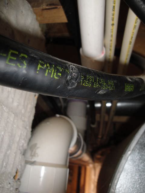

proesjb1 Posted November 29, 2010 Report Share Posted November 29, 2010 I felt compelled to register in order to post after reading this thread with much interest. I'm not an inspector but rather a homeowner who has been poring over information concerning csst and electrical arcing after having two perforated (Counterstrike) gas lines in my basement in the past week. The first leak was detected within 30 minutes of the replacement (by a licensed electrician) of a supposedly bad GFCI breaker with a non-GFCI breaker that was controlling the basement electricity. The perforated csst line (image below) had been in direct contact with a metal duct at the point of perforation. Neither the electrician or the plumber made any connection to the perforation and a potential electrical problem. Click to Enlarge 35.7 KB The second leak (on a different line, this one mounted directly to a metal duct) occurred about a week later. After this (and armed with internet knowledge) we went looking for and found the source of the electricity...a stripped electrical wire pulled tight against a duct. The GFCI breaker wasn't bad, it was tripping because of the electrical short. Our GC (new construction house) still seems incredulous that the gas lines could be perforated by arcing from duct work contacting a live wire. We are still trying to gather information and consult our own inspectors to determine if any codes were violated with the installation. Specifically whether electrical wires and/or gas lines should be contacting the ducts. Am I understanding correctly from reading this thread that contact of a csst line with metal duct is quite probably perfectly acceptable? NY is the only specific example I have foundwhere code prohibits contact of csst with metal ductwork (http://www.dos.state.ny.us/code/csst.htm). Thanks for your consideration. Jody Quote Link to comment Share on other sites More sharing options...
Jim Katen Posted November 29, 2010 Report Share Posted November 29, 2010 I felt compelled to register in order to post after reading this thread with much interest. I'm not an inspector but rather a homeowner who has been poring over information concerning csst and electrical arcing after having two perforated (Counterstrike) gas lines in my basement in the past week. The first leak was detected within 30 minutes of the replacement (by a licensed electrician) of a supposedly bad GFCI breaker with a non-GFCI breaker that was controlling the basement electricity. The perforated csst line (image below) had been in direct contact with a metal duct at the point of perforation. Neither the electrician or the plumber made any connection to the perforation and a potential electrical problem. Click to Enlarge 35.7 KB The second leak (on a different line, this one mounted directly to a metal duct) occurred about a week later. After this (and armed with internet knowledge) we went looking for and found the source of the electricity...a stripped electrical wire pulled tight against a duct. The GFCI breaker wasn't bad, it was tripping because of the electrical short. Our GC (new construction house) still seems incredulous that the gas lines could be perforated by arcing from duct work contacting a live wire. We are still trying to gather information and consult our own inspectors to determine if any codes were violated with the installation. Specifically whether electrical wires and/or gas lines should be contacting the ducts. Am I understanding correctly from reading this thread that contact of a csst line with metal duct is quite probably perfectly acceptable? NY is the only specific example I have foundwhere code prohibits contact of csst with metal ductwork (http://www.dos.state.ny.us/code/csst.htm). Thanks for your consideration. Jody Ouch, that's nasty. I suppose you realize that you're lucky that you haven't been blown up? At least one CSST manufacturer requires that it's product be kept away from ducts. The reference was in Post #13 of this thread. The problem you experienced is really quite remarkable, though. There was enough current flow to cause arcs that ate through the steel tubing but that wasn't enough to trip a breaker. In your case, the conductive sheath on the Counterstrike seems to have been part of the problem. Your case also seems to be an advertisement for Arc Fault Circuit Interrupters. And by the way, forty lashes with a wet noodle for the electrician who swapped out a GFCI for a regular receptacle without figuring out why the GFCI was tripping. He could have killed you. - Jim Katen, Oregon Quote Link to comment Share on other sites More sharing options...
Marc Posted November 29, 2010 Report Share Posted November 29, 2010 Perhaps the aluminum mesh found in Gastite's new Flash Shield CSST would conduct well enough to trip a 20 amp breaker without damaging the pressure lining. It's a different approach than the solution offered by TracPipe's Counter Strike. See Mike O's first link in post #39. Marc Quote Link to comment Share on other sites More sharing options...
Douglas Hansen Posted November 30, 2010 Report Share Posted November 30, 2010 Jody - I urge you to please save the damaged CSST. I am very sorry to learn that you had these problems in your house, and hope you realize how lucky you were that your house wasn't destroyed. I appeal to you for help in preventing someone else from becoming a fire statistic. At this time, the organization that creates our gas codes (specifically, the NFPA 54 Code Making Panel and the NFPA Standards Council) are looking at proposals and counter-proposals regarding the status of CSST in the nation's fuel gas codes. The makers of "counterstrike" presented them with arguments that their product should be exempt from bonding because they claimed it was much safer than other CSST and because it had an ICC Evaluation Service report that they claimed found the conductive material in the Counterstrike to be the equivalent of bonding with a #6 wire. I would be happy to arrange to have your damaged CSST sent to a member of the NFPA 54 Code-Making-Panel. Could you please respond to me directly at Douglas@Codecheck.com? Thank you Douglas Hansen Quote Link to comment Share on other sites More sharing options...
