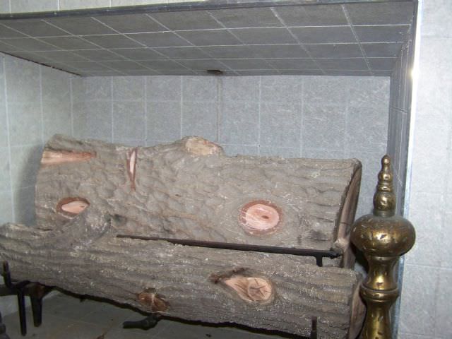

kimball gray Posted September 12, 2010 Report Share Posted September 12, 2010 This is a propane fueled log fireplace in a bedroom. The homeowner states that the liner and surround of the firebox area is original(built about 1957). He also states that they have used this appliance many times especially when the electricity goes out in the winter. It feels like a cheap or thin paneling. It has a smooth texture except in the grooves that were cut to make it appear like tile. I am looking for advice as to how to describe the material. Thanks for all of your help in advance. It is appreciated that this site allows us all to lean on some of the more knowledgable fellow professionals. Always learning as long as I am breathing! Download Attachment: 100_3400.jpg 1345.88 KB Click to Enlarge 52.44 KB Quote Link to comment Share on other sites More sharing options...
Bain Posted September 12, 2010 Report Share Posted September 12, 2010 Did ventless logs exist in 1957? Quote Link to comment Share on other sites More sharing options...
kimball gray Posted September 13, 2010 Author Report Share Posted September 13, 2010 That is one of my questions. There is no chimney or vent... Quote Link to comment Share on other sites More sharing options...
Bill Kibbel Posted September 13, 2010 Report Share Posted September 13, 2010 That's sure looks like tile-board, a water-resistant. hardboard paneling used for (cheap) tub walls. It certainly isn't original to the house. That gas/propane log set should really only be installed in listed enclosures. That home-made goofiness isn't a listed enclosure. It was probably built for the 'flickering light" electric fireplace. You can also verify that the log set is manufactured for unvented installations. I just noticed you mentioned it's in a bedroom. Many do not allow them to be installed in bedrooms. Quote Link to comment Share on other sites More sharing options...
Robert Jones Posted September 13, 2010 Report Share Posted September 13, 2010 If that material were to have been used many times as the home owner states, wouldn't there be some kind of staining on the material? It looks fairly new, or at least newly installed. Did he cover something up? Quote Link to comment Share on other sites More sharing options...
kimball gray Posted September 13, 2010 Author Report Share Posted September 13, 2010 I am not sure if he is covering something up since there is no vent or chimney. I said this was a bedroom but it could have originally been a study or office. I was guessing that the appliance and mantel were an add on. Who ever installed it did a pretty good job of making it look original to the structure. Are we sure that asbestos board/material was not produced in this form as some time? Quote Link to comment Share on other sites More sharing options...
Mike Lamb Posted September 13, 2010 Report Share Posted September 13, 2010 Bill is probably right. That looks like bath board. A masonite type product with a very thin water resistant finish. (It will fall apart in a shower or tub under wet conditions by the way). In a fire? Not a chance. Take a knife and dig at it just a little and you will know, or check the edges. While I would write it up as a fire hazard, I always recommend that a level II NFPA inspection be performed. My standard disclaimer: "O Your home inspector does NOT light fires of any kind. The seller or their agents should demonstrate the operability of fireplaces. It is also recommended that a licensed chimney sweep perform an NFPA Level II inspection which may require fishing a camera up the chimney to see what the condition of the liner is. This is beyond what your inspector does." Quote Link to comment Share on other sites More sharing options...
kimball gray Posted September 13, 2010 Author Report Share Posted September 13, 2010 Thanks to you all for the timely responses. I have already stated that it not be used until inspected further by the right specialist as stated. Thanks again.... Quote Link to comment Share on other sites More sharing options...
kurt Posted September 13, 2010 Report Share Posted September 13, 2010 It certainly could be "original" to the house, as in, some hack in 1950-something found some transite and decided to get handy and creative to please the little lady. Sure looks like a "grooved" transite to me. Take away the grooves, and it absolutely would look like transite. It's even got the little white fuzzies where the saw blade cut the grooves. Either way, I'd tell folks to tear it out because it's so stinkin' ugly, and it's probably asbestos. As a fall back, I'd tell folks it could burn down their house, or poison them with CO. As a retort the realtors and sellers, I'd tell them to shut up, I don't care what they think. I'd like to propose phrasing other than "it was observed", or "it is recommended". What is "it", and why is "it" saying these things? Do "we" exist? Is there an "I"? Or, am I trapped in a passive existentialist dilemma? Quote Link to comment Share on other sites More sharing options...
John Dirks Jr Posted September 13, 2010 Report Share Posted September 13, 2010 Did ventless logs exist in 1957? Not sure about 57 but my house was built in '62 and it had a ventless log. I'm pretty sure it was there from the beginning. Quote Link to comment Share on other sites More sharing options...

Tom Raymond Posted September 13, 2010 Report Share Posted September 13, 2010 I'm with Kurt on the asbestos. Tile look paneling is shiny, this stuff looks just like transite. I think there might still be a few sheets laying in the barn at my parent's place, I know I could build a prettier fire box than that[:-dev3] Quote Link to comment Share on other sites More sharing options...
