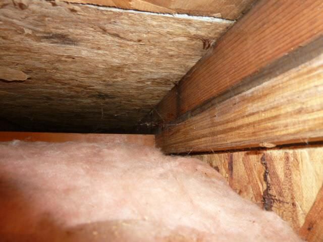

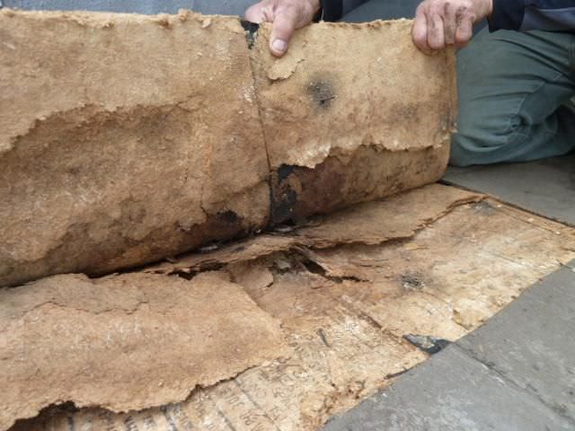

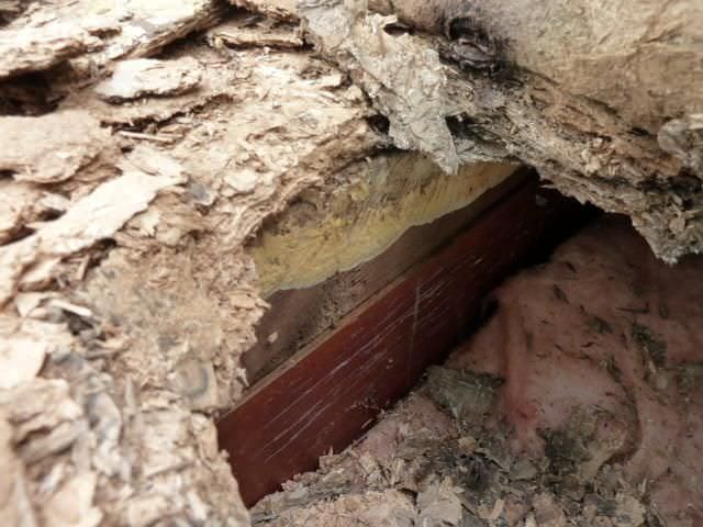

kurt Posted October 5, 2010 Report Share Posted October 5, 2010 10 year old house, drywall to the bottom of the roof joists, cavities 8" faced batt, OSB sheathing, no roof vents (not recommending they'd have stopped the problem), and pretty much ignorance on all things Joe L. Click to Enlarge 67.24 KB Click to Enlarge 64.02 KB Click to Enlarge 52.06 KB Quote Link to comment Share on other sites More sharing options...
Marc Posted October 5, 2010 Report Share Posted October 5, 2010 I don't know what a roof joist is. Could you elaborate? OSB wall sheathing or OSB roof decking? Marc EDIT: Disregard this post. Randy's post below has clued me in. Quote Link to comment Share on other sites More sharing options...
randynavarro Posted October 5, 2010 Report Share Posted October 5, 2010 Yeesh. Are those first two pics of the roof deck from above? How'd it get ripped apart? Quote Link to comment Share on other sites More sharing options...
kurt Posted October 5, 2010 Author Report Share Posted October 5, 2010 I got hired to open up a mess to figure out how bad it is. Wooof........ Yes, those are pics from standing on the roof, and sticking my camera into the joist cavity. I should have included an establishing shot...... Click to Enlarge 59.9 KB Quote Link to comment Share on other sites More sharing options...

kurt Posted October 5, 2010 Author Report Share Posted October 5, 2010 Yep, flat roof, OSB roof sheathing, TJI's and LVL roof structure. No venting system, but I don't know how you'd do it even if you wanted to; the joists run varying directions withe blocking, skylite penetrations, different levels, etc. You'd have to vent every joist cavity. Nothing particular other than a sealed joist space and no air or vapor barrier. There's huge fungal growths on the LVL's and TIJ's. I'm not sure the structure can be saved. Quote Link to comment Share on other sites More sharing options...

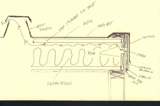

hausdok Posted October 5, 2010 Report Share Posted October 5, 2010 Hi, We have 'em here. They put vent stacks in the center and use a fascia vent at the perimeter to get air under the surface. Seems to work. Of course, we don't have winter temps like Chi-Town; so I'm not sure if it would work in your climate. ONE TEAM - ONE FIGHT!!! Mike Quote Link to comment Share on other sites More sharing options...
kurt Posted October 5, 2010 Author Report Share Posted October 5, 2010 There's no contiguous vent space. How could a central stack and perimeter vents work? Quote Link to comment Share on other sites More sharing options...
hausdok Posted October 5, 2010 Report Share Posted October 5, 2010 They'll use like an 11-7/8 I joist with 9-1/2-inch thick high performance fiberglass batts so there will be an air gap above; then vent the ends of the I-joists, use spaced blocking to create a gap between the top of the rim board and the parapet curb, apply a layer of mesh over the slot, install more spaced blocking, hang a wide fascia on that and bring the metal coping over the top of the curb and down the face of that fascia, leaving a gap behind the fascia for air to flow behind and enter the roof cavity. A long tower or parapet topped with a vent cap extends down the center of the roof perpendicular to the line of the joists. Once the roof surface heats up, convection takes over as air starts leaving the tower and pulls in fresh air at the fascia. I've emailed you a very, very rough sketch. Don't you dare snicker at my lousy drawing skills. ONE TEAM - ONE FIGHT!!! Mike Quote Link to comment Share on other sites More sharing options...

kurt Posted October 5, 2010 Author Report Share Posted October 5, 2010 OK, got the sketch, and I get it. My email response didn't get it, now I do. This might work, but understand, there's joists going in different directions all over the place hung on LVL's with hangers. It's more complicated than the sketch accounts for. Ezra, steel decking and bar joists aren't necessary for flat roofs if they're designed correctly. I look at hundreds a year that are just fine. It's about design more than materials. The real problem with this house is it was a transplanted SoCal architect building for the desert, only he happened to be @ the 42nd parallel. Stuff he did there might work, but here, it's a mold farm. It's a building science case study of how to do it exactly wrong for a particular climate. Quote Link to comment Share on other sites More sharing options...
hausdok Posted October 5, 2010 Report Share Posted October 5, 2010 Yeah, Just imagine a long narrow box with tapered sides sticking up above the roof at the inner ends of any joists that dead end in the center and at the center where any joist bays continue from one side to the other. A curved or gable cover covers the top with screened mesh down both sides under shelter of the vent overhang so animules don't get in there. It has to be high enough to place the strip vents above any snow accumulated during a storm so that ventilation isn't impeded. ONE TEAM - ONE FIGHT!!! Mike Quote Link to comment Share on other sites More sharing options...

kurt Posted October 6, 2010 Author Report Share Posted October 6, 2010 Click to Enlarge 30.59 KB Quote Link to comment Share on other sites More sharing options...
Marc Posted October 6, 2010 Report Share Posted October 6, 2010 Thanks! Nothing communicates like a drawing. It looks innovative. Marc Quote Link to comment Share on other sites More sharing options...
Jim Katen Posted October 6, 2010 Report Share Posted October 6, 2010 Thanks! Nothing communicates like a drawing. It looks innovative. Marc How does the air know where it's supposed to go? - Jim Katen, Oregon Quote Link to comment Share on other sites More sharing options...
Marc Posted October 6, 2010 Report Share Posted October 6, 2010 Thanks! Nothing communicates like a drawing. It looks innovative. Marc How does the air know where it's supposed to go? - Jim Katen, Oregon My guess is that it's pulled towards the vent tower which functions as a flue, unless the wind currents overpower it. Heat energy is added to the air at the underside of the deck and perhaps at the flue itself. Kurt seems to suggest that it works, that's the bottom line. Marc Quote Link to comment Share on other sites More sharing options...
hausdok Posted October 6, 2010 Report Share Posted October 6, 2010 Thanks! Nothing communicates like a drawing. It looks innovative. Marc How does the air know where it's supposed to go? - Jim Katen, Oregon You don't know? That's simple; Everyone has a GPS these days. ONE TEAM - ONE FIGHT!!! Mike Quote Link to comment Share on other sites More sharing options...
kurt Posted October 6, 2010 Author Report Share Posted October 6, 2010 I think there would have to be some fine point improvements to optimize convection, but generally, I think it'd work to dry out the condensation. It's still a screwed up house, but at least it might not rot away in another decade. Quote Link to comment Share on other sites More sharing options...
Tom Raymond Posted October 6, 2010 Report Share Posted October 6, 2010 Thanks! Nothing communicates like a drawing. It looks innovative. Marc How does the air know where it's supposed to go? - Jim Katen, Oregon It doesn't. It's just like every other vent scheme out there. The stack might be the only part that could reliably drive a convection current, but I doubt it's big enough. How much of that structure has to come out? If it's far enough apart, say 60-65% of the sheathing removed, it just might make better sense to strip it all and foam it. Quote Link to comment Share on other sites More sharing options...
