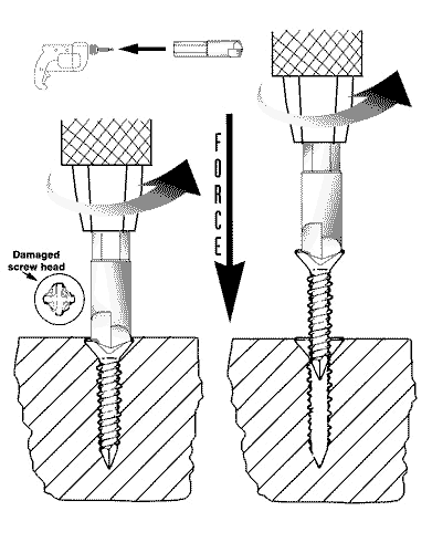

Jerry Lozier Posted October 11, 2010 Report Share Posted October 11, 2010 Deck repair. 2x6 decking and framing was put in with 3.5" deck screws. Client would really like to save decking (freestanding deck needs to be lowered 7 1/2" for headroom to awning) Sq drive / phillips combo heads are stripped bad and most are countersunk. Even drilling off heads leaves some of threads in decking so can't pry up boards Need someway if possible to back them out far enough to get vise grips? on them or core around them with small hole saw to do the same. Thought about sawzall cutting screws between joists and decking. Anything creative besides chainsaw, fire combo... Although Sounds like $400 labor to save $200 in wood? thanks.Jerry Quote Link to comment Share on other sites More sharing options...
mgbinspect Posted October 11, 2010 Report Share Posted October 11, 2010 I believe I've seen a self-tapping device that can be used in the same way you'd use a phillips head screwdriver. It's quite sharp and made specifically for your application - designed to dig into the screw head until it reaches enough resistance to back out the screw. Check with someone at Home Depot, Lowes, etc. Quote Link to comment Share on other sites More sharing options...
gtblum Posted October 11, 2010 Report Share Posted October 11, 2010 Sears has these. Click to Enlarge 15.67 KB Quote Link to comment Share on other sites More sharing options...
mgbinspect Posted October 11, 2010 Report Share Posted October 11, 2010 Yep, that's what I was referring to. They work amazingly well - razor sharp. Quote Link to comment Share on other sites More sharing options...

Jerry Lozier Posted October 12, 2010 Author Report Share Posted October 12, 2010 Sears has these. Click to Enlarge 15.67 KB never used these, have seen them advertised, worth a try. I've used easy-outs on stripped allen head bolts, however they seem to have more 'meat' to grip. Will recommend give them a try though thanks guys Jerry Quote Link to comment Share on other sites More sharing options...
Ben H Posted October 12, 2010 Report Share Posted October 12, 2010 Good Luck Jerry, I've had no luck at all with those things... My first thought was to slip a sawz-all blade between the deck and joist and cut the screws. You'll more than likely have a little grinding to do, but it shouldn't be terrible. Quote Link to comment Share on other sites More sharing options...
kurt Posted October 12, 2010 Report Share Posted October 12, 2010 One never knows without seeing everything up close and personal, but...... I've never found salvaging deck flooring to have any financial benefit. It takes more time dinking around with the stuff than you save in material cost. Also, the salvaged stuff always looks a little torn up, because it is. If you gotta be "green" and salvage, that's cool, but if it's a business decision, tear it out, and replace it. (My experience with those screw extractors is the same as Ben's; it's an iffy situation.) Quote Link to comment Share on other sites More sharing options...
gtblum Posted October 12, 2010 Report Share Posted October 12, 2010 Same here. I've had them work great, and I've had them do nothing but chew the rest of screw head into a perfect place to start the drill bit. Quote Link to comment Share on other sites More sharing options...
