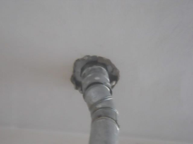

mgbinspect Posted October 21, 2010 Report Share Posted October 21, 2010 Click to Enlarge 12.29 KB OK, this question isn't about this particular situation, but more about the use of this collar in relationship to drywall in a garage: Does anyone have a clear understanding of the intended use of this collar? Is the drywall only supposed to go over the collar, but stay back from the vent pipe? Or Is the drywall supposed to go over the collar and seal tightly against the pipe? Most of the time I see it back from the pipe, and assume that's why the collar is so wide - to permit the drywall to stay back from the pipe and yet provide a seal. But, typically, the drywall doesn't end up laying nicely over the collar - leaving gaps which could permit flames a path. Opinions?... or better yet, specs? PS. If you have the proper name of this collar, I'll modify the Subject so the thread can be properly searched in the future. Quote Link to comment Share on other sites More sharing options...
kurt Posted October 21, 2010 Report Share Posted October 21, 2010 Depends on the type of collar. If it's through a ceiling, I call them a "firestop/ceiling support"; it's a simple piece of metal that provides the minimum 1" clearance around the B vent. If it's through a wall, they're usually called thimbles. If there's firestopping and minimum clearance, that should work, but it's ugly. Quote Link to comment Share on other sites More sharing options...
mgbinspect Posted October 21, 2010 Author Report Share Posted October 21, 2010 I suppose it appears that the clearance may have been provided after original installation... Quote Link to comment Share on other sites More sharing options...
Rocon Posted October 21, 2010 Report Share Posted October 21, 2010 It is a thimble. I have never heard of it refered to differently depending on location, but you know how phrases change around the country. The photo you provided shows the thimble set too far back from the surface of the drywall. The intent of the thimble is to provide the one-inch separation to framing and drywall (an air gap if you will), while still providing a block for flame and smoke spread. Usually there is some tape and mud repair around the thimble to provide a consistent joint around the annulus. Many jurisdictions also require intumescent sealant at the joint between the thimble and drywall. Download Attachment: Simpson Dura Vent 1998.pdf 135.95 KB Quote Link to comment Share on other sites More sharing options...
kurt Posted October 21, 2010 Report Share Posted October 21, 2010 Simpson describes it as firestopping in their document. They also describe through wall as a thimble. Thimbles normally do not provide firestopping; they're often vented to prevent heat build up in the wall. Either way, doesn't matter. The idea is firestopping and minimum clearances at the ceiling. Quote Link to comment Share on other sites More sharing options...

mgbinspect Posted October 21, 2010 Author Report Share Posted October 21, 2010 One thing I find a little bit humorous, is that the drywall (considered to be a firestop in this application) needs to be held back an inch from the outside surface of B Vent... Huh? That's a part of why I teed up the question - it seems that it shouldn't matter if the drywall is snugged up against the B vent. Quote Link to comment Share on other sites More sharing options...
kurt Posted October 21, 2010 Report Share Posted October 21, 2010 Practically speaking; it doesn't. I've never found a B vent that was any more than a little warm. Many of my friends in here have different experiences. OTOH, the mfg. sez 1", so that's what I say every time. Quote Link to comment Share on other sites More sharing options...
Darren Posted October 21, 2010 Report Share Posted October 21, 2010 Mike, This should clear it up for ya Download Attachment: b_90_3.pdf 29.85 KB Quote Link to comment Share on other sites More sharing options...
