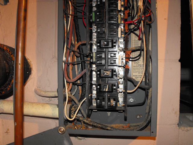

Les Posted March 30, 2011 Report Share Posted March 30, 2011 Click to Enlarge 60.38 KB Click to Enlarge 62.04 KB In Michigan we find the same situation(s) as Katen. There are exceptions, but generally Pushmatics are found in houses that were upscale. The nagging question for inspectors must be what they report and why. Doug posted a very nice clear concise answer that every inspector should read until they fully understand what he is saying. To read it and then report all 40plus year old equpipment as flawed misses the point. The "schools" must teach in a binary fashion and not encourage thought nor critical analysis. This is not just an electrical issue and it can be applied to cast iron plumbing (new and old), lead based paint, vinyl asbestos tile, vermiculite, horse hair plaster, etc. Real inspectors have opinions. Quote Link to comment Share on other sites More sharing options...

Douglas Hansen Posted March 30, 2011 Report Share Posted March 30, 2011 Back to Pushmatics, after reading over everyone's contribution I think my problems with them really are attibutable to their age more than any other factor, and that seems to vary from one locale to another. The AIC issue shouldn't matter if the panel is a subpanel. If it has a fuse main, the fuse will protect it from high fault currents. That said, I do see a couple of other problems. The picture Les posted is not exactly an argument for the case that these are somehow a more robust design, especially with the holes chewed through the fiberboard dividers. Next is the issue of handle ties. I have seen them on Pushmatics, though I would expect them to be hard to find. They are more likely to be needed now that all multiwire circuits require them. I suppose one could buy a 240-volt pushmatic breaker to get the handle tie, but it seems odd to have to pay $60+ for something that you could do for 60 cents on a modern panel. Jim, be careful. We need you. Douglas Hansen Quote Link to comment Share on other sites More sharing options...
