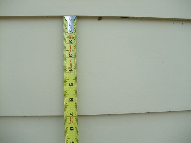

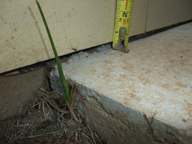

Marc Posted November 11, 2010 Report Share Posted November 11, 2010 Today's one year old house had what I first thought was fiber cement siding but after taking a photo of the bottom of the first course with my camera on the ground, I then realized that it was masonite. Click to Enlarge 50.5 KB Click to Enlarge 52.17 KB This client is taking legal action against the builder for reasons other than this masonite but I'm trying to get her as much ammo as possible. There's no fasteners on the exposed surfaces, some panels deflect when you press upon them lightly and the first course is within 2 3/4 of the soil in some places. Does anyone have a guide on masonite siding installation? Marc Quote Link to comment Share on other sites More sharing options...

Marc Posted November 11, 2010 Author Report Share Posted November 11, 2010 Year? Panel or lap? 2009. Do you call this panel or lap? Click to Enlarge 22.09 KB Marc Quote Link to comment Share on other sites More sharing options...

Chris Bernhardt Posted November 11, 2010 Report Share Posted November 11, 2010 Marc That siding in your pictures is way too thin and the edges too sharp for hardboard siding, it really looks just like a smooth face fiber cement. They stopped making Masonite, what, a decade or two ago? Chris, Oregon Quote Link to comment Share on other sites More sharing options...

Brandon Whitmore Posted November 11, 2010 Report Share Posted November 11, 2010 Looks like fiber cement to me as well. Hint: If you can't tell for sure, take the sharp point of your screwdriver, push it up against the siding, and grind slightly. You should be able to tell from there...... Quote Link to comment Share on other sites More sharing options...
Marc Posted November 11, 2010 Author Report Share Posted November 11, 2010 Looks like fiber cement to me as well. Hint: If you can't tell for sure, take the sharp point of your screwdriver, push it up against the siding, and grind slightly. You should be able to tell from there...... I scraped the bottom edge of the first course with my fingernail, as I usually do, and the material was brown, not white. I've written the report which 'suspects' hardboard and recommends that the installation be repeated with compliance with the manufacturer's installation instructions. I used LP's smartsiding manual as an example. there were many examples of a faulty installation. Marc Quote Link to comment Share on other sites More sharing options...
hausdok Posted November 11, 2010 Report Share Posted November 11, 2010 Hi Color or no, it does appear to be a fiber-cement product. If so, blind nailing is required and panel movement is pretty much the norm. BC has to be 6-inches above soil but can be down to within two inches of porches, steps, patios or other hardscaping. ONE TEAM - ONE FIGHT!!! Mike Quote Link to comment Share on other sites More sharing options...

Tom Raymond Posted November 11, 2010 Report Share Posted November 11, 2010 I still think it's hardboard. 2009 is too old to be the new Hardie, and the shadow line looks too fat to be the old. Look at the pic below, the bottom piece is brand new hardboard, the top is Hardie. Click to Enlarge 35.75 KB Based on the suppliers in my area I would guess the hardboard is from GP or Weyerhauser. I 2 stepped it so I can't be sure. Quote Link to comment Share on other sites More sharing options...
Chad Fabry Posted November 11, 2010 Report Share Posted November 11, 2010 It's not the new Hardie, the new stuff has a beveled edge. It looks like mud stained old generation Hardie or some other brand of fiber cement. No matter what it is, it's too close to grade. Quote Link to comment Share on other sites More sharing options...

Jim Katen Posted November 12, 2010 Report Share Posted November 12, 2010 If it's any help, I've seen Hardiplank in grey, white, light brown (very much like masonite in color), light blue, and pink (actually sort of a very light dusty rose). Quote Link to comment Share on other sites More sharing options...
palmettoinspect Posted November 12, 2010 Report Share Posted November 12, 2010 I'd say from the first picture that looks like a hardboard product. The third picture looks like a smooth face Hardiplank. If I can’t tell for sure I take my pocket knife and cut a VERY small piece in an inconspicuous place to see for sure. It’s easy to tell once you have a small piece in hand. Quote Link to comment Share on other sites More sharing options...
