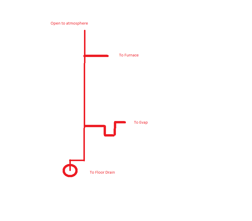

hausdok Posted November 18, 2010 Report Share Posted November 18, 2010 Hi All, This is for you guys who regularly see AC systems. I've got a condensate line from a Cat IV furnace joined to to a trapped condensate line from an A-coil downstream from the trap. I seem to recall some kind of prohibition against using the same drain for condensate from both a Cat IV furnace and an AC A-coil unless there is an air gap between the two. Did I imagine that or is there an actual prohibition? I've been digging around but I can't seem to find it. Does it ring a bell with anyone? ONE TEAM - ONE FIGHT!!! Mike Quote Link to comment Share on other sites More sharing options...
Richard Moore Posted November 18, 2010 Report Share Posted November 18, 2010 No ringing bells, or code, but if the connection is made below the outlets at both the AC and furnace, so that there's no way for condensate from one to feed into the other, I don't see how it could cause any problems. It's not like they are both going to be running and creating condensate at the same time. OK...one scenario, I suppose, would be if the termination froze up and then furnace condensate might be forced into the AC? Seems a bit unlikely, but I can see how an air-gap would prevent that. I'm really not helping at all, am I? [:-paperba Anyway...got a picture of the set-up? We are taking about a gravity feed from the furnace and not a pump, right? Quote Link to comment Share on other sites More sharing options...
Terence McCann Posted November 18, 2010 Report Share Posted November 18, 2010 Refer to pick Mike. The way mine is piped. It has to open to atmosphere so the line does not become pressurizied when the trap for the evap dries out (even though it is open to the drain). My furnace is a counterflow so the evap sits below the furnace. Click to Enlarge 16.24 KB Quote Link to comment Share on other sites More sharing options...
hausdok Posted November 18, 2010 Author Report Share Posted November 18, 2010 Hi Terry, Yeah, that's exactly how this one is done. I always thought there was supposed to be a separation where that furnace drain meets the evaporator drain. Guess not. ONE TEAM - ONE FIGHT!!! Mike Quote Link to comment Share on other sites More sharing options...
Terence McCann Posted November 18, 2010 Report Share Posted November 18, 2010 I uploaded a Trane Upflow/ Horizontal Gas-Fired, Direct Vent Condensing Furnaces Install Guide to the library Mike. Take a look. One thing is odd in the piping diagram, they don't show a trap for the evap condensate line and it should have one. Quote Link to comment Share on other sites More sharing options...
