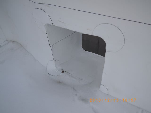

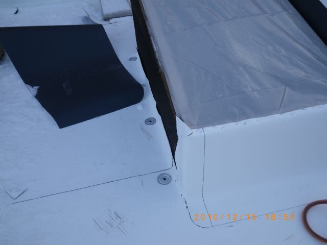

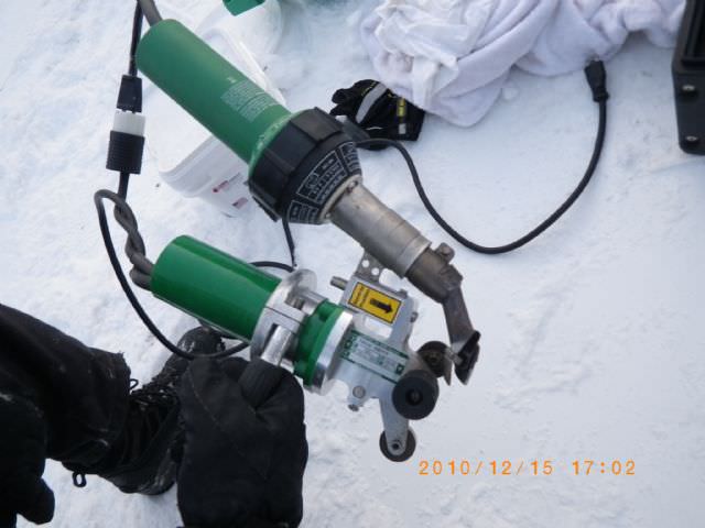

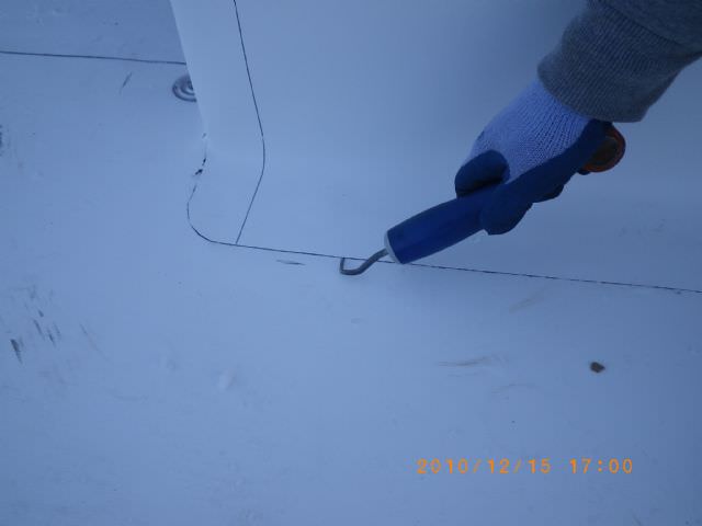

kurt Posted December 16, 2010 Report Share Posted December 16, 2010 Here's a little pictorial of a TPO install. I'm owner's rep on this gig. The start is tear off everything there to expose the sheathing, repair whatever is screwed up, and cover it with 1" polyiso, then a 1/2" expanded perlite Fesco board, then the TPO. Anyone wonders, this is a wonderful system; the hot air welders are a miracle. No flame, quiet, and relatively easy to operate. While not always liking what I've seen with TPO, this is the 60 mil. All of what I've seen is 40 mil; the 40 mil seems to bag, and it just seems "thin". There's also an 80 mil, which I'll be seeing in 3 months on another job. It was all shot on the Pentax W90 [utube] " type="application/x-shockwave-flash" wmode="transparent" width="425" height="344"> The following shows some basics: This is the field seamer; I didn't get any video of this, but you can figure it out from the video; it's a hot air welder, and those two rollers pinch and seal the seam. Click to Enlarge 42.81 KB This is a basic layout @ the base: Click to Enlarge 23.78 KB All seams are tested with this pick shortly after running the seam; it's on the back end of the roller too: Click to Enlarge 16.77 KB Here's the basic reinforcement patches: Click to Enlarge 16.44 KB The membrane is extended through the scupper hole: Click to Enlarge 15.63 KB This metal has TPO bonded to the bottom, and the steel on top is welded/soldered to the metal gutter box (in this case, it's going to be copper). You can see the white layer on the "left" edge (opposite side from the label). I'll be showing the copper when it goes in. Click to Enlarge 35.21 KB Quote Link to comment Share on other sites More sharing options...

randynavarro Posted December 17, 2010 Report Share Posted December 17, 2010 So the hot air welder melts the two layers of TPO together, thus the real definition of "welding", right? Quote Link to comment Share on other sites More sharing options...
kurt Posted December 17, 2010 Author Report Share Posted December 17, 2010 Yup. It's amazingly cool how the air welder works. Quote Link to comment Share on other sites More sharing options...

BornaRoofer Posted May 17, 2011 Report Share Posted May 17, 2011 Just a few comments. You should never glue tpo unless its 40 deg and rising. And you shouldnt glue anything to fesco it will never stay stuck. Fesco is for hot asphalt only. Insulation is to be fastend with 3" plates and tpo is to be fastend with 2" barbed plates. And he was holding that leister welder backwards in the seam as he welded. I hope it holds up for you. Quote Link to comment Share on other sites More sharing options...
kurt Posted May 17, 2011 Author Report Share Posted May 17, 2011 Well, that would surprise the mfg. rep who blessed the installation, and the installer that has his training cert from the mfg. It'll hold up. Quote Link to comment Share on other sites More sharing options...
