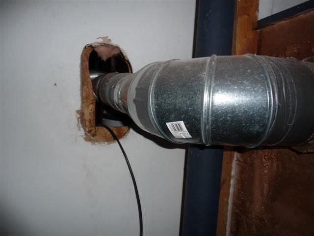

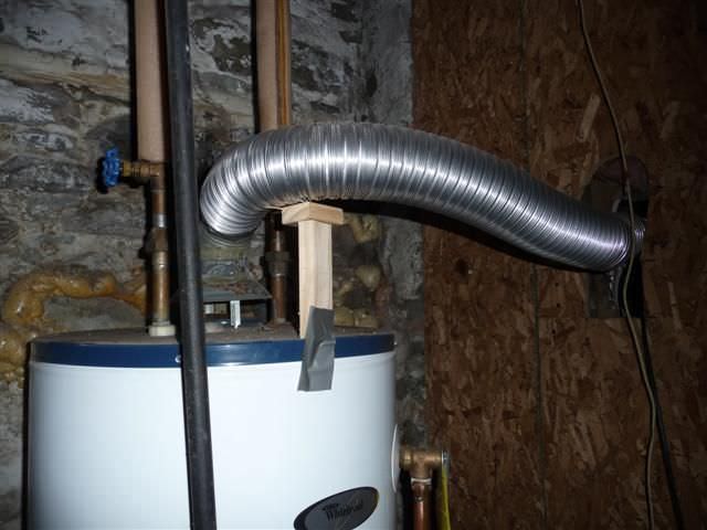

gtblum Posted December 22, 2010 Report Share Posted December 22, 2010 I'm told the guys that flipped this house, are none other than the two sons of a very good friend of mine, who just happens to sit on the E board of the plumbing local here. They also have an uncle who will likely get the nod to straighten this mess out. I can only imagine the fun they'll have at the family Christmas eve party. Click to Enlarge 41.7 KB Click to Enlarge 46.93 KB Click to Enlarge 30.2 KB Quote Link to comment Share on other sites More sharing options...
Bill Kibbel Posted December 22, 2010 Report Share Posted December 22, 2010 They're real close to breaking every single rule of vent installations. Quote Link to comment Share on other sites More sharing options...

Mark P Posted December 22, 2010 Report Share Posted December 22, 2010 They actually cut the soffit to run it up just outside a window! What did they do to seal between the flue and the hole in the soffit / fascia? And I like the little wood kick stand taped to the side of the water heater, keeping flue from sagging more. That is the funnest thing I've seen in awhile. Quote Link to comment Share on other sites More sharing options...
