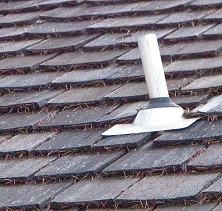

Ken Meyer Posted December 23, 2010 Report Share Posted December 23, 2010 This vent is coming out at an odd angle, but I couldn't find anything specifically addressing vents out of plumb in Code Check. What are the implications of an out of plumb vent, if any? Click to Enlarge 56.98 KB Click to Enlarge 54.49 KB Quote Link to comment Share on other sites More sharing options...
Jim Katen Posted December 23, 2010 Report Share Posted December 23, 2010 I'm not aware of any requirement that they be plumb. As long as they drain rainwater & condensation, I don't see a problem. Well, except that it looks stupid. - Jim Katen, Oregon Quote Link to comment Share on other sites More sharing options...

fyrmnk Posted December 23, 2010 Report Share Posted December 23, 2010 Only thing I could think of would be the extra stretch in portions of the sealing boot. They deteriorate and split here all the time without the undue stress. Quote Link to comment Share on other sites More sharing options...
wilhomes Posted December 23, 2010 Report Share Posted December 23, 2010 As a former builder, it looks very unprofessional Quote Link to comment Share on other sites More sharing options...
