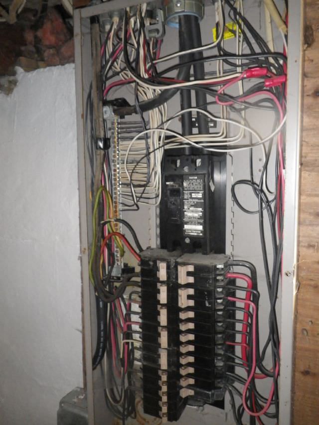

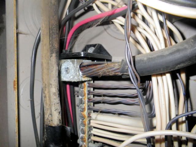

Mark P Posted January 4, 2011 Report Share Posted January 4, 2011 Inside this cuttler-hammer panel in the basement of a 1904 farm house all the exposed copper wire has turned to a pale grey color. I suspect fertlizer was stored in the same room causing the discolorization. This is the 1st time a can remember seeing this, but have read about it and understand it can be caused by swiming pool chemicals, drug labs, chinese drywall, etc. Do you have any information on discolorization and if it is known to cause any problems. This is an after the fact finding missioin for me, because I'm calling for a sparky to take a look as there were a few other problems as well and my client is a relocation company. Click to Enlarge 88.04 KB Click to Enlarge 56.52 KB Click to Enlarge 90.83 KB Quote Link to comment Share on other sites More sharing options...
hausdok Posted January 4, 2011 Report Share Posted January 4, 2011 Hi Mark, Was there a laundry area in that basement? I'm thinking chlorine bleach. Saw the same thing yesterday on a panel stored in a laundry room with a noticeable chlorine bleach odor. ONE TEAM - ONE FIGHT!!! Mike Quote Link to comment Share on other sites More sharing options...

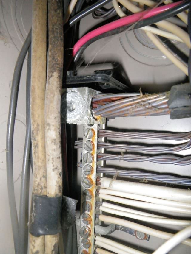

Tom Raymond Posted January 4, 2011 Report Share Posted January 4, 2011 Household cleaning chemicals are nasty, the hinges on the cabinet I keep mine in are corroded badly. Look again at the third pic, that neutral cable is introducing water into that panel. Quote Link to comment Share on other sites More sharing options...
Mark P Posted January 4, 2011 Author Report Share Posted January 4, 2011 No Mike, not a laundry room, however, the laundry is directly above this room and the dryer vents into this room. Lint everywhere. Thanks Tom, I noticed that. Quote Link to comment Share on other sites More sharing options...
inspector57 Posted January 4, 2011 Report Share Posted January 4, 2011 Ding, Ding, Ding, we have a winner. High humidity and vaporized chemicals pumped into the space enclosing the electric panel. Quote Link to comment Share on other sites More sharing options...
Bill Kibbel Posted January 5, 2011 Report Share Posted January 5, 2011 That particular color on copper is from sulfates. Hydrogen sulfide gas reacting with water is one likely possibility. Ammonium sulfate is second. It's found in insecticides, herbicides, fungicides and fertilizer. Quote Link to comment Share on other sites More sharing options...
robert1966 Posted January 5, 2011 Report Share Posted January 5, 2011 I have seen discolored copper from chemical vapors, one time it even corroded the cabinet hinges next to the panel.... There appeared to be brass hinges as well. Chlorine and other chemical vapors can cause severe corrosion and discoloration. Quote Link to comment Share on other sites More sharing options...
msteger Posted January 5, 2011 Report Share Posted January 5, 2011 Good catch. There's no way to know if any of that corrosion exists at the important connections, so report it and recommend a licensed and qualified electrician fully evaluate the panel's components to check each connection. Quote Link to comment Share on other sites More sharing options...
