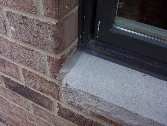

Mike Lamb Posted January 5, 2011 Report Share Posted January 5, 2011 Most of the stone sills on this house did not extend completely beneath the windows. I don't see why this is any problem to write up. Am I missing anything? Click to Enlarge 59.95 KB. Quote Link to comment Share on other sites More sharing options...
Ben H Posted January 5, 2011 Report Share Posted January 5, 2011 Looks like crap... but I'm in your corner with not really significant. Quote Link to comment Share on other sites More sharing options...
Jim Baird Posted January 8, 2011 Report Share Posted January 8, 2011 At least they appear to have some slope. Here the brick masons seem to have forgotten that brick sills should slope at all. Quote Link to comment Share on other sites More sharing options...
