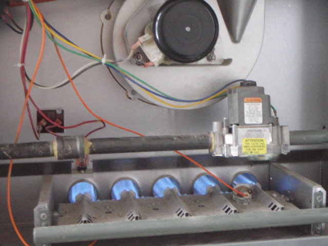

Jerry Lozier Posted January 8, 2011 Report Share Posted January 8, 2011 Home with (possible heat pump) and mid efficency Rheem gas furnace. Could not find/access data plate on outside unit to verify if it is a heat pump. 3Thermostats (big house) all were heat pump type, were set to heat and the little red light glowing indicating aux heat? about 30 degrees outside today Question: I've never seen both heat pumps and gas furnaces together on same system.... always one or the other.... so does gas furnace come on when temp gets low to indicate need for aux heat (rather than go to HP aux heat) or is this an a/c unit with heat pump thermostats or?? inquiring minds need to know?? Download Attachment: P1070019.JPG 73.74 KB Download Attachment: P1070020.JPG 75.26 KB Download Attachment: P1070042.JPG 78.43 KB Download Attachment: P1070046.JPG 81.46 KB Quote Link to comment Share on other sites More sharing options...
Bill Kibbel Posted January 8, 2011 Report Share Posted January 8, 2011 Probably a heat pump with gas for back-up, instead of electric elements. They're very common here. You can always confirm it's a heat pump by finding the reversing valve at the outdoor unit. At 30°, you should have been able to operate it on the heat pump mode and even check the defrost cycle. Quote Link to comment Share on other sites More sharing options...
Jerry Lozier Posted January 8, 2011 Author Report Share Posted January 8, 2011 Bill I set system to off on all thermostats.... waited a while until nothing running then set to emergency heat and gas furnace started.... shut down again, waited and set to 'heat' a couple degrees over room and still no heat pump as gas furnace fired again, ran until thermostat was satisfied. Breaker was on, and fuse block in outside sub was installed... Guess you answered question, as have not seen a HP go to a gas furnace for emegency heat before, although certainly makes sense and probably better. and you are right usually I see HP working into 20's or below before emerg heat starts, nothing out of outside unit today Quote Link to comment Share on other sites More sharing options...
