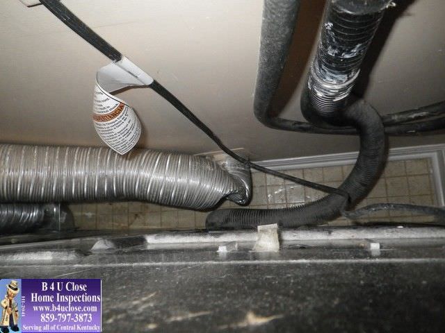

John Kogel Posted January 9, 2011 Report Share Posted January 9, 2011 Take a picture of the vent pipe where it comes out the back. Sometimes that gets crushed when they push the dryer back into position. Quote Link to comment Share on other sites More sharing options...

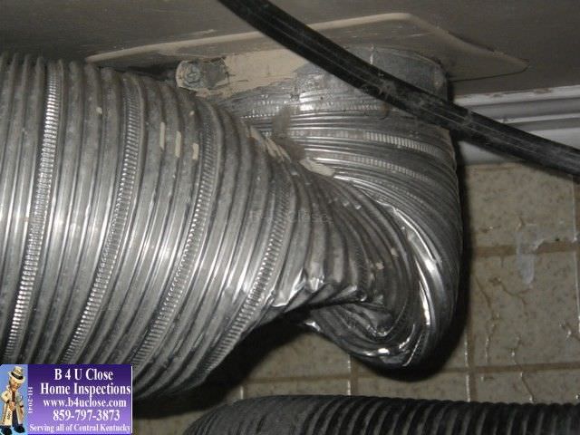

gpdewitt Posted January 12, 2011 Report Share Posted January 12, 2011 I've also found them crushed. Found one metal flex between the dryer and the (1 foot long) solid vent to exterior that was fully extended to TEN FEET and then practically tied in a knot to fit it behind dryer and then mashed up against gas supply line! People had lint all over the room and couldn't figure it out. Cut flex down to 3 feet long, excising ripped part, and all was well. Also, lint (or sock or whatever) could be somewhere between lint trap and outlet in the dryer, hardware stores sell a special long thin brush you can use to clean this area. Sold as a brush to clean refrigerator coils. Quote Link to comment Share on other sites More sharing options...
Erby Posted March 8, 2013 Report Share Posted March 8, 2013 Found this just the other day. Click to Enlarge 56.45 KB Click to Enlarge 61.51 KB Quote Link to comment Share on other sites More sharing options...
