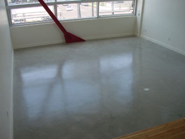

hausdok Posted January 26, 2011 Report Share Posted January 26, 2011 It's a labor intensive solution, but years ago when I was in Korea the landlord was installing a bathroom to replace the banzo - outside outhouse. They came in and completely lined that sucker with a really hard aggregate bearing colored concrete of some sort; and then, using what looked like mongo-sized rotary sanders with diamond cutting heads, polished those surfaces until they glistened like the fender on a new Benz at the dealership. After that, they sealed the surface with something that I'd guess was a clear acrylic. Looking at that and realizing that the stuff that looked like granite chips in the surface was gravel that had been ground down flat on one side, I was simply amazed with the result. However, I did feel sorry for the phalanx of middle-aged ladies wearing gloves and sleeve covers that spent a day kneeling or standing there wrestling those heavy electric grinders to achieve that beautiful surface. I can imagine that they all suffered from wrist and tendon ailments. I don't know if that was a technique the Koreans had dreamed up on their own or they'd seen it somewhere else. Has anyone here ever seen anything similar done? ONE TEAM - ONE FIGHT!!! Mike Quote Link to comment Share on other sites More sharing options...

kurt Posted January 27, 2011 Report Share Posted January 27, 2011 It's really pretty simple. Simple, with a lot of hard labor to install it. The old stuff used multiple bed layers of concrete or cementitious material, with a final layer of mortar rich mud embedded with marble or stone chips, ground flat and sealed. If there were color variations, metal screed strips were set in the mud as dividers. The new stuff is polymer or epoxy based. Same basic process, but without all the bed layers. I'll bet the Korean stuff was a portland rich material, maybe with some volcanic ash, embedded with stone chips, then ground flat just like terrazzo. Historically, they've found the stuff in neolithic Western Asian archeological digs dating back 8000-9000 years. They used burnt lime and clay, bedded it with stone chips, and I have no idea how it was "ground" or "polished". The stuff was/is remarkably moisture resistant, which I suspect is due to the high lime content. It had to be if they're digging up 10,000-11,000 year old stuff that's still partially intact. Quote Link to comment Share on other sites More sharing options...
Jim Katen Posted January 27, 2011 Report Share Posted January 27, 2011 . . . They used burnt lime and clay, bedded it with stone chips, and I have no idea how it was "ground" or "polished". . . I read somewhere (old issue of Smithsonian?) that they'd sprinkle the floor with abrasive grit and then run a "bear" (a large stone with a flat bottom) back & forth over the floor. When they reached a certain level of finish, they'd clean it all up and start over with a finer grit until they reached the desired level of polish. Quote Link to comment Share on other sites More sharing options...

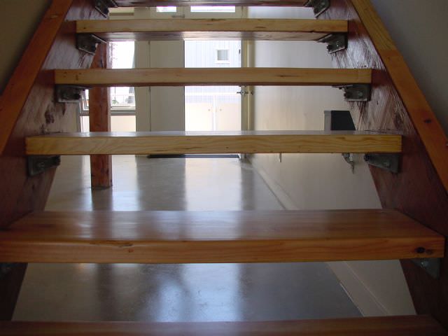

Rocon Posted January 30, 2011 Report Share Posted January 30, 2011 It's a labor intensive solution, but years ago when I was in Korea the landlord was installing a bathroom to replace the banzo - outside outhouse. They came in and completely lined that sucker with a really hard aggregate bearing colored concrete of some sort; and then, using what looked like mongo-sized rotary sanders with diamond cutting heads, polished those surfaces until they glistened like the fender on a new Benz at the dealership. After that, they sealed the surface with something that I'd guess was a clear acrylic. Looking at that and realizing that the stuff that looked like granite chips in the surface was gravel that had been ground down flat on one side, I was simply amazed with the result. However, I did feel sorry for the phalanx of middle-aged ladies wearing gloves and sleeve covers that spent a day kneeling or standing there wrestling those heavy electric grinders to achieve that beautiful surface. I can imagine that they all suffered from wrist and tendon ailments. I don't know if that was a technique the Koreans had dreamed up on their own or they'd seen it somewhere else. Has anyone here ever seen anything similar done? ONE TEAM - ONE FIGHT!!! Mike Mike, I did it in Venice CA several years ago for lightweight concrete floors, as well as podium decks. Wealsoinstalled conrete couters with the same techniques. The floors were ground with the same machines used in Terrazo. And for anyone that has never seen this check out Cheng design (he has a book out that is worth purchasing) and Buddy Rhodes studio (sells propriatary mix) for alot of interesting things. Many things can be added to the mix and ground down. I have seen some showers where the cement is cast into large panels polished and then adhered to the wall surfaces like tile this created a similar look to the earlier photo. http://www.chengdesign.com/geocrete-countertops.html http://www.buddyrhodes.com/ Cheng has videos located her also: http://www.concretenetwork.com/news/ Here are some pictures of one of the floors: Click to Enlarge 36.93 KB Click to Enlarge 36.21 KB Click to Enlarge 26.36 KB For comparison here is one of the unpolished floors: Click to Enlarge 39.34 KB Ramon Quote Link to comment Share on other sites More sharing options...
hausdok Posted January 30, 2011 Report Share Posted January 30, 2011 Hi Ramon, Thank you for those photos and thanks to the other guys for letting me know about the terrazo. ONE TEAM - ONE FIGHT!!! Mike Quote Link to comment Share on other sites More sharing options...
