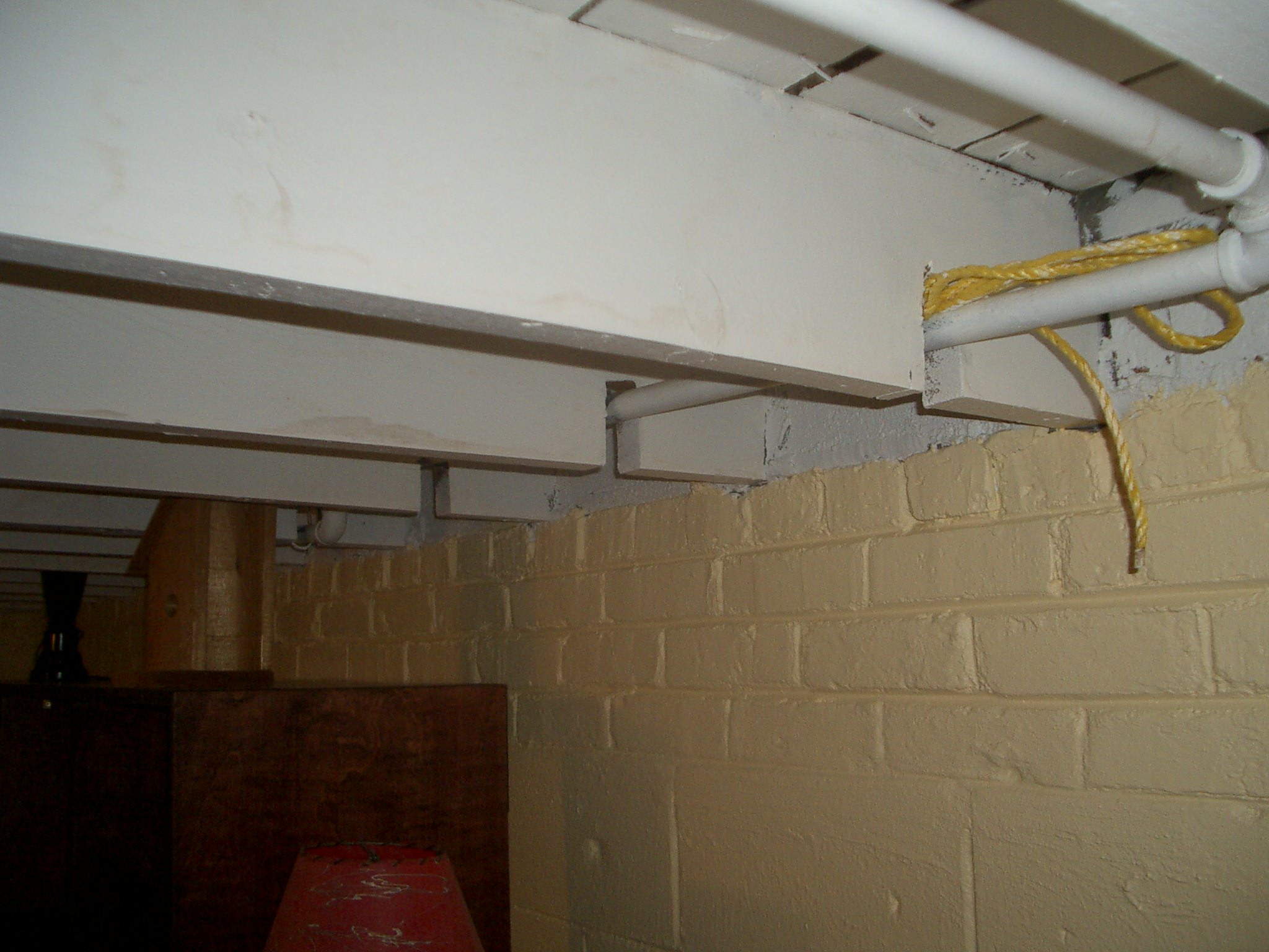

Gordon Posted February 6, 2005 Report Share Posted February 6, 2005 Hello everyone. A friend of mine has this great St. Patrick's Day party every year, and invites alot of people-kind of an open house invite. The problem is, he and his wife moved into a house last year that needs work. I'm going to be helping him get this work done before St. Patty's (he has fears of people falling through the floor), because he has 5 joists that have been notched at least half way up, to accommodate the gas fuel run, which I'll be re-routing for him next weekend. Question: what is the best way to repair these joists, without having to replace them all? I imagine some type of metal brace could do the trick, but I'm uncertain of what type to get. I appreciate the future input. Download Attachment: Crilly 3.jpg 980.02 KB Quote Link to comment Share on other sites More sharing options...
chrisprickett Posted February 6, 2005 Report Share Posted February 6, 2005 While I'm not an engineer, and will disavow any responsibilty if you all fall through the floor and die, it give it a shot: Option 1: Sister a same size joist the entire length of the notch joist (this may not be practical) Option 2: Add a "flitch plate". A 1/4" steel plate roughly the same width as the affected joists, with pre-drilled staggered holes. Run it about 6' out from the affected area. Installed it like a sandwich between the affected joist, and a 6' 2x of the same dimension. Through bolt through all three. Do this to all the notched joists. Quote Link to comment Share on other sites More sharing options...
Jim Katen Posted February 6, 2005 Report Share Posted February 6, 2005 Originally posted by Gordon. . . Question: what is the best way to repair these joists, without having to replace them all? I imagine some type of metal brace could do the trick, but I'm uncertain of what type to get. I appreciate the future input. Run a girder under the notched joists. Support it with posts and nice broad footings. - Jim Katen, Oregon Quote Link to comment Share on other sites More sharing options...
Brian G Posted February 6, 2005 Report Share Posted February 6, 2005 I'm with Jim. Nothing beats direct bearing. Brian G. Quote Link to comment Share on other sites More sharing options...
Gordon Posted February 6, 2005 Author Report Share Posted February 6, 2005 We already have a joist to replace, and it's not one of the ones notched out. Replacing these other 5 isn't practical though. Sometime in the future, the basement is going to be refinished, and the idea of support bearings is also impractical, though I agree, the best option. I'll run over all the options again with him, and let him decide. I appreciate all the info! Thanks! Quote Link to comment Share on other sites More sharing options...
Brooks J. Peterman Posted February 6, 2005 Report Share Posted February 6, 2005 I like Chris' "flitch plate" idea. You could gusset them with heavy plywood glued and nailed from the bearing to 4' to 6' behind the notches. Similar to the flitch plates but you don't have to find them or have them made. Engineered I joists are repaired like this all the time. If done correctly, relocating the gas pipe may not be necessary. (edited to add comment) Quote Link to comment Share on other sites More sharing options...

Steven Hockstein Posted February 6, 2005 Report Share Posted February 6, 2005 If there are wires or pipes passing through the joists, another option is to install steel angles along the bottoms of the joists. Quote Link to comment Share on other sites More sharing options...

rfarrell Posted February 17, 2005 Report Share Posted February 17, 2005 A few years back I had a situation where the plumber notched a series of second floor joists for a waste pipe. He paid for the engineering and repairs. The engineer speced 3/4 plywood full height both sides lagged and glued. The gussets either three or four feet in length and centered on the notch. That was a compression repair but I think you would find an engineer would approve something like that for this repair. The plumber re-installed the waste pipe through the gussets, also approved by the engineer. Quote Link to comment Share on other sites More sharing options...
