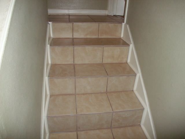

Marc Posted February 2, 2011 Report Share Posted February 2, 2011 Click to Enlarge 26.79 KB Aside from being a lousy choice because it's so slippery, is there anything in the IRC or IBC about it? Marc Quote Link to comment Share on other sites More sharing options...

gtblum Posted February 2, 2011 Report Share Posted February 2, 2011 Forget the tile itself. How about the no nosing part? Quote Link to comment Share on other sites More sharing options...
Marc Posted February 2, 2011 Author Report Share Posted February 2, 2011 Gee, that's right. I'll check for a bullnose requirement in the codes. Marc Quote Link to comment Share on other sites More sharing options...
Brandon Whitmore Posted February 2, 2011 Report Share Posted February 2, 2011 According to the ORSC (Oregon res. code) nosings aren't required if the tread is at least 10". What does the IRC say-- I don't have my book handy? I'm not aware of codes addressing slick surfaces on stair treads. I write up hardwood treads and recommend a non slip surface be applied quite often. Quote Link to comment Share on other sites More sharing options...
Chad Fabry Posted February 2, 2011 Report Share Posted February 2, 2011 IN NY, the treads have to be at least 11" to have no nosing- those treads are 12"? Quote Link to comment Share on other sites More sharing options...
Marc Posted February 2, 2011 Author Report Share Posted February 2, 2011 I didn't think of measuring them while onsite. In the absence of a slam dunk, I'll pass on this issue especially since the client made a decision after the verbal report to walk away from the house (based on other numerous findings). Thanks for all the responses. Marc Quote Link to comment Share on other sites More sharing options...

kasterko Posted October 10, 2012 Report Share Posted October 10, 2012 How about an opposite situation. The treads were replaced and the nosing trim sticks up about 1/4" . This makes it an uneven stair tread with a little stop. It could also be a trip hazard depending on foot size. Wish I had a pic but the nosing is like a transition piece that's a little thicker than the tread. Quote Link to comment Share on other sites More sharing options...
allseason Posted October 10, 2012 Report Share Posted October 10, 2012 The next time you walk up a set of stairs with no nosing notice how your toes hit the risers. Quote Link to comment Share on other sites More sharing options...
