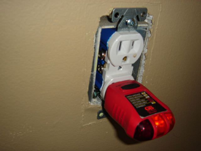

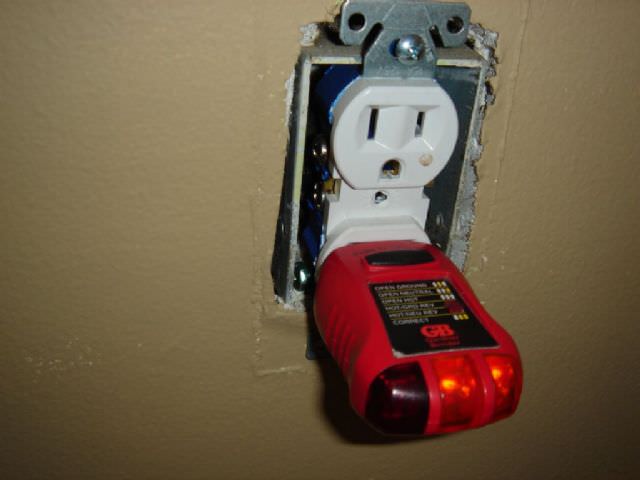

Bain Posted February 5, 2011 Report Share Posted February 5, 2011 A majority of the electrical outlets in a house I checked out yesterday showed positive for grounding, however there weren't any wires connected to the green screws. How is this possible? Even if the junction boxes were grounded--and there was no evidence of that in the crawlspace--shouldn't the tester display "open ground?" Click to Enlarge 29.42 KB Click to Enlarge 31.84 KB Quote Link to comment Share on other sites More sharing options...
John Kogel Posted February 5, 2011 Report Share Posted February 5, 2011 If this is an old two wire system, the only possible grounding would be "bootleg", where the neutrals are jumpered to the ground screw, in the back of the j box. Then grounding for the pin is achieved thru the two screws holding the receptacle. Because neutral is grounded in the panel, you get a false ground at the receptacle. You didn't say if the supply cables have the ground wire, but assuming the ground wire is there, 3 wire system, it is likely wrapped around the ground screw in the back of the box. I think those are metal j boxes, but even the plastic boxes will often have a ground strap to one of the mounting screws. Quote Link to comment Share on other sites More sharing options...
Marc Posted February 5, 2011 Report Share Posted February 5, 2011 Is that a metal box? Maybe the box is grounded and the screw carries the ground to the outlet. Marc EDIT: John K beat me to it. Quote Link to comment Share on other sites More sharing options...
John Kogel Posted February 5, 2011 Report Share Posted February 5, 2011 Marc, I beat you by 2 seconds! Type faster! [] Quote Link to comment Share on other sites More sharing options...
Bain Posted February 5, 2011 Author Report Share Posted February 5, 2011 They WERE metal boxes, so I think you nailed it. I just wasn't clear on how the tester could be fooled if there was no direct connection to the ground-prong slot. Quote Link to comment Share on other sites More sharing options...

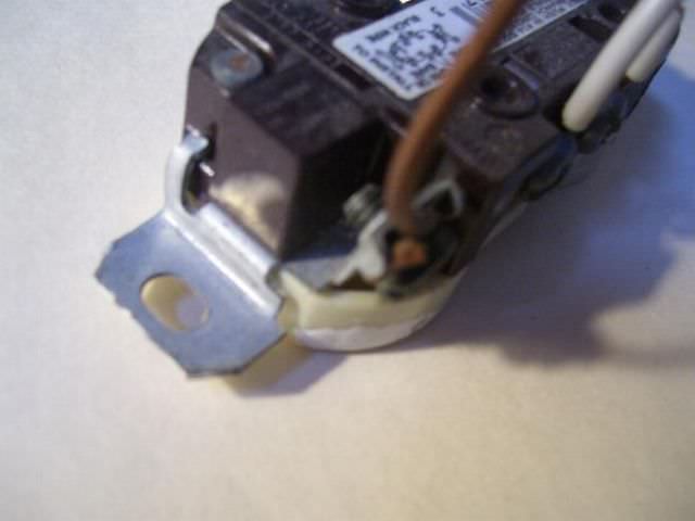

Bill Kibbel Posted February 5, 2011 Report Share Posted February 5, 2011 The tab for the ground screw is the same piece of metal stamped for the mounting screws. Click to Enlarge 28.27 KB Quote Link to comment Share on other sites More sharing options...
Bain Posted February 5, 2011 Author Report Share Posted February 5, 2011 The tab for the ground screw is the same piece of metal stamped for the mounting screws. Click to Enlarge 28.27 KB Ahhhh, that's so simple, I'm embarrassed I wasn't aware of it. Thank you. Quote Link to comment Share on other sites More sharing options...
