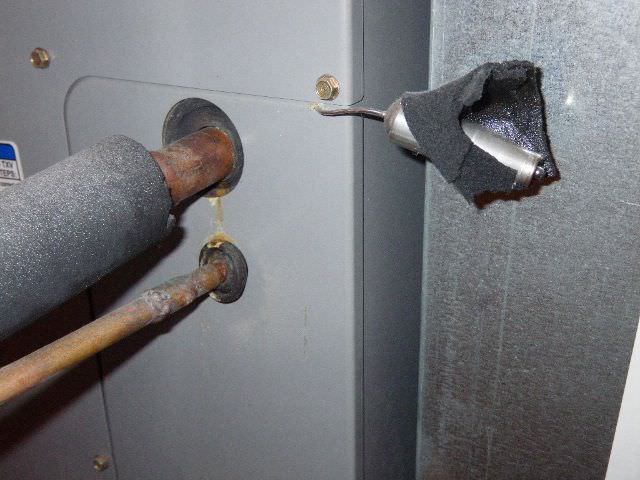

Garet Posted February 21, 2011 Report Share Posted February 21, 2011 What is it? Looks similar to the sensor on a thermal expansion valve Is there a TXV inside the evaporator coil housing? If so, I assume it should be in contact with the suction line? Click to Enlarge 56.69 KB Quote Link to comment Share on other sites More sharing options...
Terence McCann Posted February 21, 2011 Report Share Posted February 21, 2011 Your correct in your assumptions. If the unit has been running with powerhead sensor off the suction line there a really good chance the compressor has taken a few slugs of liquid. I would think that it should have been installed in the cabinet as well. Looks like the cap line is pinched where it exits the cabinet. Quote Link to comment Share on other sites More sharing options...
