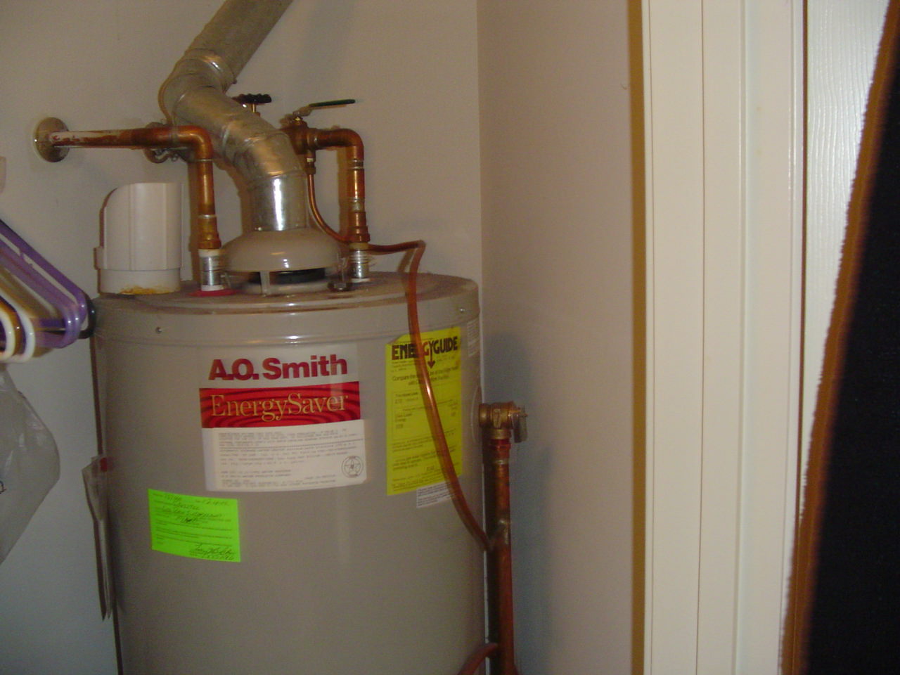

Bain Posted February 15, 2005 Report Share Posted February 15, 2005 I found this in a 4-year-old house during my morning gig. Why is there tubing between the supply pipe and the T-P valve tubing? The ball valve is open, however no water was discharging from the T-P tubing at ground level. John Download Attachment: DSC00886.JPG 517.93 KB Quote Link to comment Share on other sites More sharing options...

Bill Kibbel Posted February 16, 2005 Report Share Posted February 16, 2005 It seems that the ball valve w/drain was added after installation. Isn't that a repair coupling after the elbow above the tank? The cap was removed from the valve's drain to connect the tubing. I would think water would be discharging continuously. We answer a lot of questions during an inspection. The one I can't always answer is "Why the hell did someone do that?" Quote Link to comment Share on other sites More sharing options...
Jim Katen Posted February 16, 2005 Report Share Posted February 16, 2005 Someone's idea of a trap primer? Was there a floor drain near the TPR discharge? It looks like there's another valve on this same pipe (behind the vent). Is this so. Where there two valves in a row? - Jim Katen, Oregon Quote Link to comment Share on other sites More sharing options...
Bain Posted February 16, 2005 Author Report Share Posted February 16, 2005 This house was on a slab. The second gate valve is the main shut-off for the house. The water heater was on the second floor, and the end of the exterior T-P tubing was totally dry. Though I've never seen one this small, I wondered if the fitting beneath the ball valve was some sort of pressure regulator that discharged excess water down the T-P tubing. With the valve open and the tubing dry, little else makes sense. Bill. I, too, often answer, "No clue," when asked why a tradesperson would make a bonehead move. But still, someone went to a lot of effort to configure this water heater. It makes me wonder---what was he or she trying to accomplish? Quote Link to comment Share on other sites More sharing options...

Neal Lewis Posted February 16, 2005 Report Share Posted February 16, 2005 Since the water heater is on the second floor, I would expect to see a vacuum relief valve. Could it be some type of antisyphon piping arrangement? Quote Link to comment Share on other sites More sharing options...
Bain Posted February 16, 2005 Author Report Share Posted February 16, 2005 Mystery solved. I phoned the realtor this morning to see if any improvements had been mentioned on the seller's disclosure. Turns out the seller had installed a sink for her in-home hair salon in one of the lower-level rooms. Everything had been removed and sealed--hopefully that includes the drain line and vent if one ever existed--and the wall had been patched leaving no trace. The pressure-relief tubing had been transformed into a supply-pipe!!!! Thanks to me, the sellers are now incensed that they have to re-remove the drywall to make certain the T-P tubing doesn't terminate at a shut-off valve, which of course shouldn't have been enclosed in the first place. I always try to give tradespeople the benefit of the doubt, but what kind of numbskull could have in good conscious made this modification? John Quote Link to comment Share on other sites More sharing options...

Erby Posted February 17, 2005 Report Share Posted February 17, 2005 Bain, I've seen something similar to this a couple of times out in the country around here when there is another level above the level the water heater is on. Their logic is that they use the TPR drain pipe,running off to a floor drain or wherever, to drain the supply pipe whenever they need to do so. Open the valve, the water runs out into the TPR drain pipe and off to the discharge, or so their theory goes. Quote Link to comment Share on other sites More sharing options...
