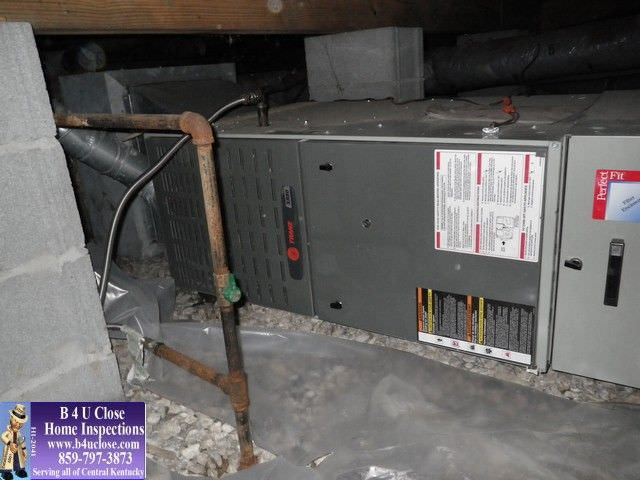

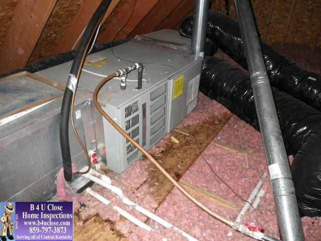

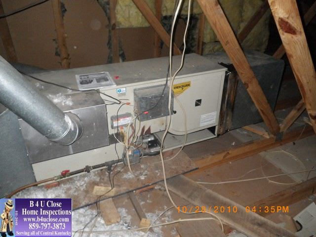

Erby Posted March 3, 2011 Report Share Posted March 3, 2011 I see them, here in Central Kentucky, in attics and crawl spaces all the time. Those are the most common locations around here. In the house or garage is not quite so common. Click to Enlarge 65.27 KB Click to Enlarge 53.48 KB Click to Enlarge 57.53 KB Common write-ups for attic units include: The insulation should be removed from overflow drain pan under the attic heating & cooling unit. It can block the overflow drain line and cause the overflow water to drip onto the ceiling below. There is no safe walkway or working platform for the attic heating and cooling equipment. Generally accepted building practices call for a 24 inch wide walkway, from the attic hatch to the equipment, and a 30" x 30" working platform on the side of the unit where access panels are located for the safety of repairmen working on the equipment. I recommend the addition of a safe walkway and working platform for this attic heating & cooling unit. There is no secondary condensate drainage protection for the attic heating & cooling unit. Generally accepted building practices call for secondary condensate drainage protection for units located where damage to the building will occur if the primary condensate drain plugs up with gunk. The secondary condensate drainage protection is usually a drain pan with a separate drain to a visible location or a water detection device that will shut the unit down if the primary drain is blocked. Failure to have a secondary means of condensate drainage protection can allow water to damage the structure below the unit if the primary drain blocks up. Have a heating and air conditioning contractor install a secondary means of condensate drainage protection. I've yet to see a condensate drain line freeze up. Quote Link to comment Share on other sites More sharing options...

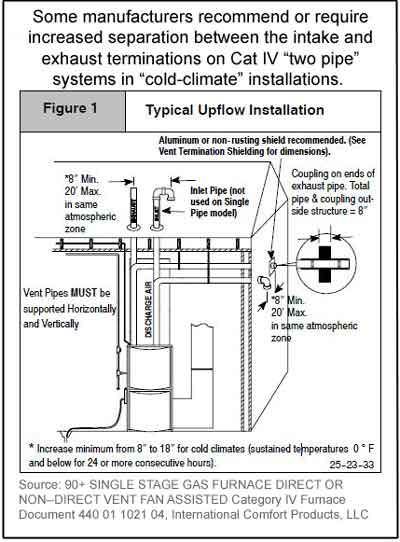

mthomas1 Posted March 4, 2011 Report Share Posted March 4, 2011 Mike, One thing to keep in mind: Click to Enlarge 52.59 KB Quote Link to comment Share on other sites More sharing options...
