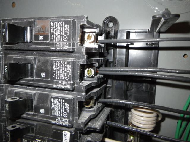

In-Depth Posted March 4, 2011 Report Share Posted March 4, 2011 This is from a 2006 condo conversion. There are 2 double tapped breakers in the panel in the unit. The panel is a Siemens, the breakers are 20 amp Siemens Type QP L-5538, serving 2-12 ga wires. I'm thinking no, this breaker is not designed to accept two wires. I'm just doubting myself because the panels were professionally installed, and a city electrical inspector signed off on the install(not that either of these mean anything!). I can't find any pertinent info on the Siemens website or doing a google search. Maybe I'm just overtired and overthinking this... Thanks, Jim Click to Enlarge 61.74 KB Click to Enlarge 49.27 KB Quote Link to comment Share on other sites More sharing options...
Jim Katen Posted March 4, 2011 Report Share Posted March 4, 2011 No. Those breakers are not listed to accept more than a single wire. If they were, they'd be labeled for it. - Jim Katen, Oregon Quote Link to comment Share on other sites More sharing options...
In-Depth Posted March 4, 2011 Author Report Share Posted March 4, 2011 Thanks Jim! Like I said, I'm overtired and overthinking this! Jim Quote Link to comment Share on other sites More sharing options...
