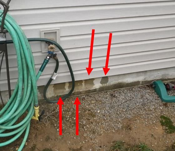

Erby Posted March 6, 2011 Report Share Posted March 6, 2011 Click to Enlarge 50.81 KB Quote Link to comment Share on other sites More sharing options...
Mark P Posted March 6, 2011 Report Share Posted March 6, 2011 That would be a great area to scan with an IR camera. Quote Link to comment Share on other sites More sharing options...
Erby Posted March 7, 2011 Author Report Share Posted March 7, 2011 Why! Perhaps I should have been more explicit. Water was running out from behind the siding, where the slab is wet, when the hose bib was turned on. You know it's leaking, you know there's water damage in the wall. Rip it out past the damaged area, fix the pipe, replace any damaged material including moldy - mildewy stuff. Time to move on. No IR Scan needed to see that. Quote Link to comment Share on other sites More sharing options...
Jim Katen Posted March 7, 2011 Report Share Posted March 7, 2011 Why! Perhaps I should have been more explicit. Water was running out from behind the siding, where the slab is wet, when the hose bib was turned on. You know it's leaking, you know there's water damage in the wall. Rip it out past the damaged area, fix the pipe, replace any damaged material including moldy - mildewy stuff. Time to move on. No IR Scan needed to see that. I don't want to speak for Mark, but one good reason to scan it would be to learn what the area looks like when rendered in IR. It'll help the user to identify future conditions the next time when there are no obvious signs of a leak. Quote Link to comment Share on other sites More sharing options...
Erby Posted March 7, 2011 Author Report Share Posted March 7, 2011 Well crap. Here comes Jim spewing logic. Dang it anyway. Mark: Send me you IR Camera and I'll go scan it for you and send you back a picture of it. Oh, and thanks for the IR camera. - Quote Link to comment Share on other sites More sharing options...

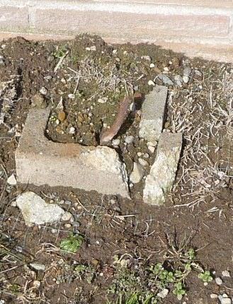

Richard Moore Posted March 7, 2011 Report Share Posted March 7, 2011 Talking of obvious plumbing leaks, here's the crawl from today...1954, one-owner home. Download Attachment: 110306X 098s.jpg 130.06 KB The pipe on the right is the water service entry, and on the left is what appears to be a cold joint. You can't really tell from the photo but water was cascading down the wall from both areas like those decorative water features. Just outside is the era-typical bent rod shut-off. Looked like it had been reefed on at some point. Click to Enlarge 55.88 KB Is "Further Excavation Needed" a report category? Quote Link to comment Share on other sites More sharing options...
