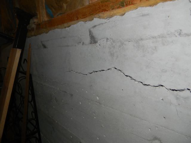

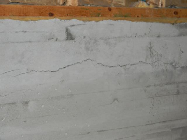

Ben H Posted March 10, 2011 Report Share Posted March 10, 2011 Whatcha think? Basement wall, looked bowed out a bit, but so much stuff in the way I couldn't sight down it. No water signs at all. And, have you guys ever seen insulation used as sill seal? Click to Enlarge 30.05 KB Click to Enlarge 30.29 KB Quote Link to comment Share on other sites More sharing options...
Tom Raymond Posted March 10, 2011 Report Share Posted March 10, 2011 How old is it? That looks like slip formed concrete, which would be much older than the framing in that pic. There was a fiberglass sill seal still in use in the late 1980's, but given the ragged edge at the top of that stem wall are you sure it wasn't stuffed in later? Quote Link to comment Share on other sites More sharing options...
Darren Posted March 10, 2011 Report Share Posted March 10, 2011 If that was from water pressure, I'd expect to see it about a foot to 18 inches lower on the wall. Quote Link to comment Share on other sites More sharing options...
Ben H Posted March 10, 2011 Author Report Share Posted March 10, 2011 Late 80's construction. Thats what I thought too Darren, it's awful high up on the wall. I know the establish shot sucks, but the stepped foundation wall was about 6ft or so at this point. If not pressure, what would cause the bow/crack in a wall like this? It was big, close to 1/4 at the widest point. Quote Link to comment Share on other sites More sharing options...
Brandon Whitmore Posted March 10, 2011 Report Share Posted March 10, 2011 Is that crack right at grade level or slightly lower? Perhaps some heavy equipment drove across the ground in the area and caused it. Quote Link to comment Share on other sites More sharing options...
Ben H Posted March 10, 2011 Author Report Share Posted March 10, 2011 Yes, just below grade, about a foot. I thought that too, perhaps a unruly skid steel driver during construction. I'm just not sure. Either way it's a punt I think. I sure as hell don't wanna miss judge this one. Quote Link to comment Share on other sites More sharing options...

Jerry Simon Posted March 11, 2011 Report Share Posted March 11, 2011 Any rust stains? Re-bar getting wet, corroding, expanding. . . Quote Link to comment Share on other sites More sharing options...
Bill Kibbel Posted March 11, 2011 Report Share Posted March 11, 2011 It really looks like an impact. I sure as hell don't wanna miss judge this one. Who is this Miss Judge? Quote Link to comment Share on other sites More sharing options...
Greg Booth Posted March 11, 2011 Report Share Posted March 11, 2011 May be seeing something that's not there.......but from the sill, down to the first slip-form joint, the concrete texture appears different. Could be a cold joint or later repair? Quote Link to comment Share on other sites More sharing options...

emalernee Posted March 11, 2011 Report Share Posted March 11, 2011 I was thinking a cold joint that got hit, also. Quote Link to comment Share on other sites More sharing options...
kurt Posted March 11, 2011 Report Share Posted March 11, 2011 The more I think about it, impact seems the most logical thing. I just don't see a crack at grade being caused by water heaving on the foundation. I suppose it could, but I've never seen it. Final, I'd have to eyeball the thing all the way down the line, even if I had to move stuff. It's the only way to know anything for sure. Quote Link to comment Share on other sites More sharing options...
Rob Amaral Posted March 11, 2011 Report Share Posted March 11, 2011 How deep does 'Jack" go there in winter (Mr. Frost)? Horizontal cracks are not good ju-ju... could be Jack Frost.. was the grade relatively flat or negative adjacent to the foundation.. ? Any pics demonstrating the 'bulge'? Hard to tell from your photo.. Quote Link to comment Share on other sites More sharing options...
Ben H Posted March 11, 2011 Author Report Share Posted March 11, 2011 When I say this basement was packed, I mean PACKED. Only a small path to the door next to the crack. If that door had not beer there, it would have been covered up to. I couldn't get a good look at the other side because of the very low deck mounted off the back of the house. The last deck I build with permits (2008) the AHJ required 24" footer, but I think the frost line is 18". I'm sure Bain or Erby will correct me if not.....it's still early right now. [] Quote Link to comment Share on other sites More sharing options...
