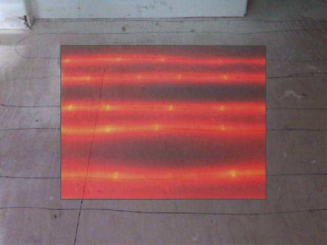

David Meiland Posted March 17, 2011 Report Share Posted March 17, 2011 The laser pointer would be useful to me when mapping out radiant tubes. As it is, I use a sharpie marker taped to a stick. Not real high tech but it works. An IR window is a view port installed into the housing of a piece of equipment, so you can shoot through it without opening the cover panel. They're made of some bizarre materials and are transparent to IR wavelengths. http://www.fluke.com/fluke/usen/products/ir-windows.htm I paid the same as Kurt for my Ti32. Of course he's right about the file format, but if you want to edit the image in the office you need to save as an .is2 file, do your editing, then export as a .jpg. I tweak pretty much every image before pasting it into a report. Quote Link to comment Share on other sites More sharing options...

David Meiland Posted March 17, 2011 Report Share Posted March 17, 2011 The laser pointer would be useful to me when mapping out radiant tubes. As it is, I use a sharpie marker taped to a stick. Not real high tech but it works. Hee hee, You've just set a bunch of 'em back on their heels. They're all goin' "What the f....!" ONE TEAM - ONE FIGHT!!! Mike I get calls to go out and locate tubes so that someone can drill a hole or nail down a floor. If it's an exposed concrete or tile floor, I have to "point" to the tubing loops so that someone else can lay down blue tape as we go... this might be made easier with a laser pointer, but I would worry like hell that the laser is pointing to the right spot and that there's not parallax error in play... unless you can see the laser spot on the screen... dunno about that, never tried. If I can draw on the floor with a marker, I tape one to a stick and sometimes add a piece of aluminum tape to the end of the marker for thermal contrast. With the wide angle lens I can easily cruise along and draw lines while looking at the screen. The laser would be useless for this. The easiest way to do this is to get 3 or 4 sharpies, put them in the refrigerator, and then use them one at a time until they warm up, then switch. The cold marker shows up perfectly against the warm floor and you can really fly. Download Attachment: tubes.jpg 26.03 KB Quote Link to comment Share on other sites More sharing options...
kurt Posted March 17, 2011 Report Share Posted March 17, 2011 That.........is a cool idea. Quote Link to comment Share on other sites More sharing options...
