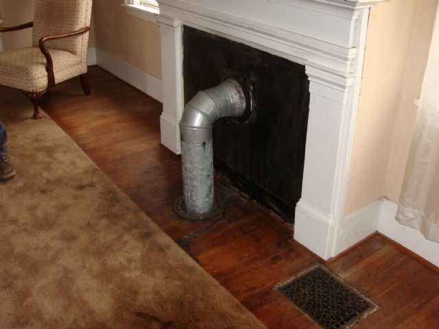

Greg Booth Posted March 22, 2011 Report Share Posted March 22, 2011 Click to Enlarge 40.91 KB Today's inspection. In an 1860's farmhouse Carrier, oil fired warm-air furnace, circa 1998. The install of the furnace was well done........excellent ducting, (supply and return), neat piping and wiring etc. But, the installer must have left the flue connection up to the home owner. Up through the floor and poked into the unlined, crumbling fire place/chimney. Leaks through the fire place surround had saturated the carpet/oak T&G flooring. Quote Link to comment Share on other sites More sharing options...

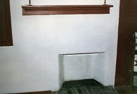

Bill Kibbel Posted March 24, 2011 Report Share Posted March 24, 2011 We once bought a home that had the oil-fired boiler venting into the side of an abandoned fireplace above. The single-walled flue connector passed through closets on each level. I added an additional terra cotta lined flue alongside the existing chimney. The wife insisted on putting the bricked-up fireplace back into service. I removed one brick and found the firebox completely packed with oil-burner soot. I reached into the soot and pulled out a mummified bird. I then mortared the removed brick back in and said "Sorry Hon, we have enough fireplaces already". That didn't deter her at all. She busted out the bricks, removed the soot and 26 dead birds. Click to Enlarge 40.89 KB Click to Enlarge 15.43 KB Quote Link to comment Share on other sites More sharing options...
AHI in AR Posted March 24, 2011 Report Share Posted March 24, 2011 Click to Enlarge 40.91 KB Other issues aside, that is simply stunningly ugly. Quote Link to comment Share on other sites More sharing options...

Brandon Whitmore Posted March 28, 2011 Report Share Posted March 28, 2011 Now if that were a "B" vent with proper clearances, and the vent ran all the way to the top of the chimney, would there be any code violations? Assuming everything else was installed properly, such as a fire stop. Quote Link to comment Share on other sites More sharing options...
