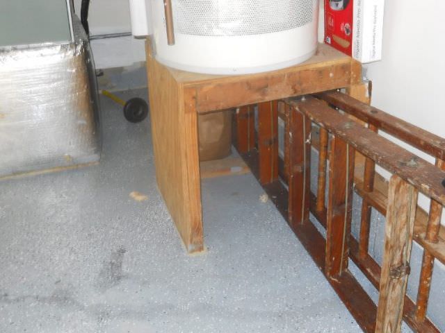

mgbinspect Posted March 23, 2011 Report Share Posted March 23, 2011 The more you look at this scenario, the scarier it gets. It's kinda like looking into one of those posters to see other images within the image. Click to Enlarge 54.98 KB Click to Enlarge 48.89 KB The framing doesn't rely on a header and jack. (The cross-member is merely toe-nailed into the stud with 6 penny nails. So, in reality, the only thing holding the whole affair together is the ply-wood shelf top.) The toe-nailed joints are pulling apart as the cross-member is pushed down and away from the stud under the weight of the full water tank There is no diagonal bracing, so the whole affair can parallelogram if the nails against the outer wall pull out. The whole mess is combustible There is no impact protection, which wasn't required when the house was built, but boy does it need it now. The water alone in the fifty gallon tank weighs 417.5 pounds, let alone the weight of the water heater (probably about 600 lbs total?) As I was explaining this to the defensive macho listing agent he walks over and starts pushing at the whole thing with his foot - ("Yeah, that's it idiot. Keep that up. You'll excuse me as I inch toward the open overhead door...") Quote Link to comment Share on other sites More sharing options...

Garet Posted March 23, 2011 Report Share Posted March 23, 2011 The whole mess is combustible The label on my gas water heater tank says "May be installed on combustible flooring." Is there some rule I'm not aware of? Quote Link to comment Share on other sites More sharing options...

mgbinspect Posted March 23, 2011 Author Report Share Posted March 23, 2011 The whole mess is combustible The label on my gas water heater tank says "May be installed on combustible flooring." Is there some rule I'm not aware of? Yeah, honestly I wasn't making a "code" statement about it being combustible, but I think resting a 600 lbs gas water heater on such a frail wood platform up off the concrete floor in a garage is a really bad idea. Doesn't steel or masonry seem a lot safer? [:-graduat Quote Link to comment Share on other sites More sharing options...

rbaake Posted March 29, 2011 Report Share Posted March 29, 2011 As far as I'm aware, gas water heaters in garages need to be raised 18" above the floor. I don't think there's any mention how they need to be supported. Is this the plumbing inspectors area of expertise...I don't know? ...would you call out the TPR extension as not terminating 6" from the floor on this installation? Quote Link to comment Share on other sites More sharing options...
Robert Jones Posted March 29, 2011 Report Share Posted March 29, 2011 Roy, I am fairly certain that water heaters with FVIR(flammable vapor ignition resistant), are not required to meet the 18". I am sure it is dependent on the area you live. I know here, I am starting to see them on the floor more regularly now. Quote Link to comment Share on other sites More sharing options...
mgbinspect Posted March 29, 2011 Author Report Share Posted March 29, 2011 My main concern isn't minor code issues. I did notice the extension being more than 6" off the floor, but didn't worry about it since the water heater needs to be relocated. The BIG problem is that 600 lbs of water heater is balanced on that front 2x4 assembly and braced by the rest of that mess. It's flat out dangerous. The 2x4 cross members that extend bac to the wall are moving down and away from the front assembly, under the weight of the water heater. So really, the brace is slowly diminishing to be just the plywood. I couldn't sleep at night knowing that such a heavy piece of gas equipment was tetering on a tight rope out in my garage. Quote Link to comment Share on other sites More sharing options...
Denray Posted April 6, 2011 Report Share Posted April 6, 2011 The vent connectors don't have much of a slope either. Quote Link to comment Share on other sites More sharing options...
gpdewitt Posted April 6, 2011 Report Share Posted April 6, 2011 OK, let's say that the wood platform is built like a train trestle, what else is wrong with the platform? It's missing a drip pan, that's what. A water heater will always leak at some point, then the wood will rot and you know the rest. Out here in CA, there are a number of other items may be wrong, YMMV. Should have: flex water connectors, flex gas connector, gas sediment trap, earthquake bracing straps, TPR line extended to the outside of the building and terminating within 2' of ground pointed down, protection from car(as you said). I consider all of these safety issues, none are mere minor code. You're right, it must be moved if only to comply with safety related code re: clearance around the electrical panel. Also agree with Denray, don't see much slope in vents. A disaster waiting to happen, soon... Quote Link to comment Share on other sites More sharing options...
