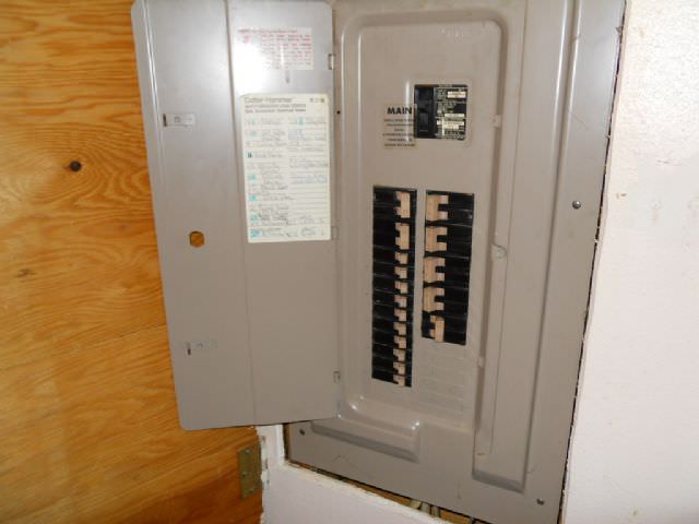

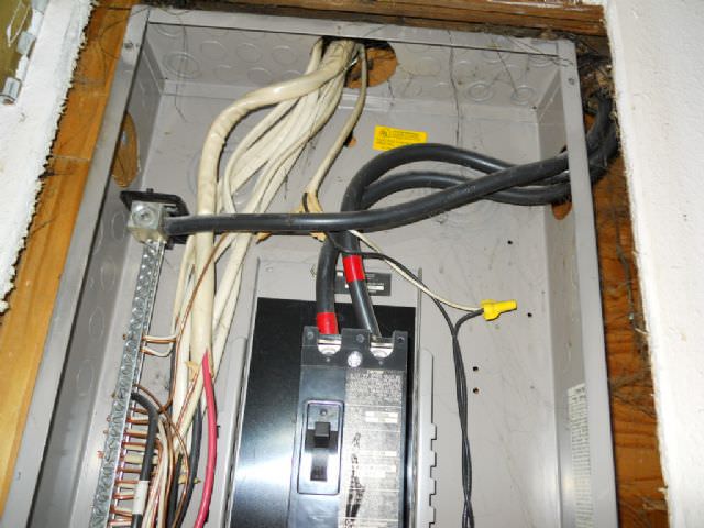

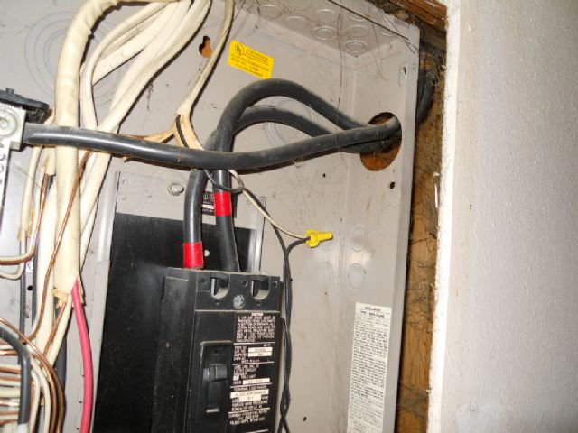

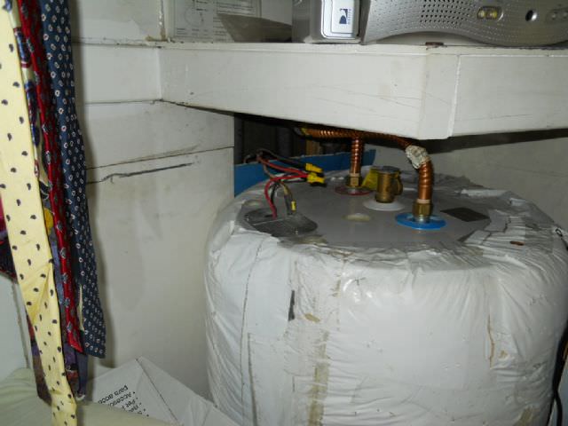

hausdok Posted March 23, 2011 Report Share Posted March 23, 2011 Hi All, Some interesting photos sent to me by Jim Simmons - user name Mr. Electric. Jim wrote: Home inspectors need to know the basic's of electrical safety. This panel is an example of why I think it is important for home inspectors to at least look inside the panel. In this case there are very obvious problems that he/she would have (should have) noticed. The main service wires are not in conduit! Very dangerous and illegal. Note the open knock-outs at the top and bottom of the panel where the conductors enter the panel; they are just shoved through the open hole! Most of the time home inspectors are the ONLY people to see these homes. They need to know when it doesn't look right! They need to be trained on the the basics. According to Jim, he was asked to look at the job by a contractor he occasionally works with. He was asked to look at the only two issues that the home inspector had noted - no flexible metallic conduit on the water cable conductors and no heater in one of the bedroom. He took it upon himself to at least look in the panel before adding a heater; that's when he found what you see in the photos below. Besides the electrical stuff, there isn't any discharge tube on the T & P valve and there isn't any seismic restraint on the tank. Don't know if the "inspector" noticed these issues or not. When stuff like this, which a supposedly competent and licensed home inspector had already inspected, gets discovered by a real pro it's embarrassing as hell; and, as someone who's busted his tail for 15 years to try and raise the bar in this state, it's pretty discouraging. [:-banghea I hope Jim can find out who this yahoo was, 'cuz if he does the inspector is going to get a call from Department of Licensing. Grrrr, days that start like this make me crazy. ONE TEAM - ONE FIGHT!!! Mike Click to Enlarge 34.54 KB Click to Enlarge 59.26 KB Click to Enlarge 56.49 KB Click to Enlarge 43.63 KB Click to Enlarge 33.52 KB Quote Link to comment Share on other sites More sharing options...

allseason Posted March 23, 2011 Report Share Posted March 23, 2011 Even if the deadfront was not removed the lack of strain relief on the cables is seen from the outside. As far as recourse, in NJ you can file complaints with the Div. of Consumer Affairs, the Home Inspection Advisory Board. Or you can litigate. Quote Link to comment Share on other sites More sharing options...

Erby Posted March 23, 2011 Report Share Posted March 23, 2011 Did Jim mention the neutrals lugged with the grounds Was there stuff in front of the panel that prevented the inspector from getting to the panel? Don't kill him until you hear his story. Quote Link to comment Share on other sites More sharing options...
fyrmnk Posted March 23, 2011 Report Share Posted March 23, 2011 Did Jim mention the neutrals lugged with the grounds Was there stuff in front of the panel that prevented the inspector from getting to the panel? Don't kill him until you hear his story. That was my first thought, but Mike advised he only listed the couple of issues on the inspection. I sure would list an inaccessible panel as a problem. Might be more to the story though just the same. Quote Link to comment Share on other sites More sharing options...
allseason Posted March 24, 2011 Report Share Posted March 24, 2011 Now that I took a closer look at all the pics I realize the outer portion of the enclosure is not visible until the deadfront is removed. In NJ the SOP is to remove all accessible covers. If I can't access I report it and tell them to re-inspect or call electrician. Quote Link to comment Share on other sites More sharing options...

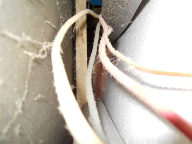

hausdok Posted March 25, 2011 Author Report Share Posted March 25, 2011 Jim Simmons just sent me a response to some questions on the thread. I had a request to point out the issues for a few people so I put together a word file that has the pictures and the issues pointed out. I know some of you understand and may not need the clarification (feel free to delete it), but for others it may be helpful. By the way I also give any of you the right to forward it to someone that might be able to benefit from it, or to use it on web sites. I left the pictures full size so you should be able to open them to get a closer look. Jim P. Simmons Mr. Electric I've attached the document he sent me below. ONE TEAM - ONE FIGHT!!! Mike Download Attachment: MainPanel IssuesForJimSimmonsPost.doc 1434.05 KB Quote Link to comment Share on other sites More sharing options...
