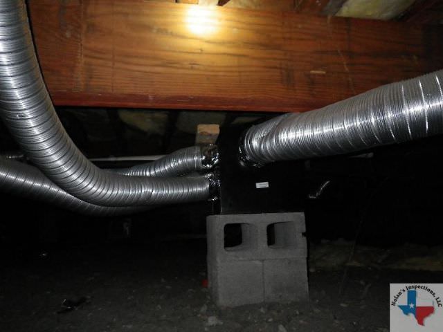

Robert Jones Posted April 5, 2011 Report Share Posted April 5, 2011 4 year old home and this in-line fan was partially installed in the crawl space. Possible attempt at conditioning the crawl? The flex duct is not connected but ran to the other side of the crawl cavity. Click to Enlarge 67.76 KB Click to Enlarge 45.8 KB Quote Link to comment Share on other sites More sharing options...

Brandon Whitmore Posted April 5, 2011 Report Share Posted April 5, 2011 It has been a couple of years since I've seen one, but I've run into similar fans used to ventilate ends of crawlspaces that had no foundation vents. Did you check out the fan model number and see what it was listed for? Quote Link to comment Share on other sites More sharing options...
John Kogel Posted April 5, 2011 Report Share Posted April 5, 2011 Well Robert's busy, so I took a look at the Nutone ILF130 manual and found this: NOTE: If used for dryer boosting the ventilator must be mounted at least 12 feet from the dryer outlet. For gas fired dryers the ventilator capacity (CFM) must not exceed the dryerââ¬â¢s fan capacity. They really need to staple that wiring up to the joists. Quote Link to comment Share on other sites More sharing options...
hausdok Posted April 5, 2011 Report Share Posted April 5, 2011 Hi, It might not be for a dryer at all. There is one large builder here that keeps building homes with half the vents blocked by flatwork. Their cure for this is to install these in crawlspaces and then run a duct to the far corner of the area where the vents are blocked. They seem to think that it will somehow provide enough movement of air that there won't be any moisture issues. Most of the time it doesn't work; in fact, I've found significant fungal growth in a few of them. ONE TEAM - ONE FIGHT!!! Mike Quote Link to comment Share on other sites More sharing options...

John Kogel Posted April 5, 2011 Report Share Posted April 5, 2011 Hi, It might not be for a dryer at all. There is one large builder here that keeps building homes with half the vents blocked by flatwork. Their cure for this is to install these in crawlspaces and then run a duct to the far corner of the area where the vents are blocked. They seem to think that it will somehow provide enough movement of air that there won't be any moisture issues. Most of the time it doesn't work; in fact, I've found significant fungal growth in a few of them. ONE TEAM - ONE FIGHT!!! Mike Right. I think by creating negative pressure in the crawlspace, they are drawing moist air in, a lot of it from upstairs. I see an occasional bath exhaust fan in the crawlspace, but when there are no other vents to let air in, it's a joke. I tell people to leave them turned off. Every area has their own solutions, but here, a lot of the new crawlspaces have electric heat, so warming the air a bit works just fine. No need to blow it around. Quote Link to comment Share on other sites More sharing options...
Nolan Kienitz Posted April 5, 2011 Report Share Posted April 5, 2011 I came across one of Broan In-Line Ventilators in a crawlspace last week. Install doc attached. Download Attachment: Broan_MP280_ExhaustFan_InstallationGuide.pdf 245.36 KB Click to Enlarge 39.44 KB Quote Link to comment Share on other sites More sharing options...

Robert Jones Posted April 5, 2011 Author Report Share Posted April 5, 2011 Sorry for the delay in response. Mike your explanation of the restricted vents due to flat work is pretty much on the money. This is a custom home with an in ground salt water pool in the back yard and nothing but flat work along the sides and back of the home. The crawl space cavity was dry and fungus free. It looks as though the vent was in the process of being installed and then stopped. Would you call for the fan installation to be completed? Or since there is no negative effects of not having one, just let the client know what it is and the theory behind it. Quote Link to comment Share on other sites More sharing options...
hausdok Posted April 6, 2011 Report Share Posted April 6, 2011 I'd go with the second option. I'd probably also recommed they saturate the hell out of all of the framing and flooring in those areas with BoraCare just to be safe. (I'm tend to take a sort of a belt and suspenders approach to stuff.). ONE TEAM - ONE FIGHT!!! Mike Quote Link to comment Share on other sites More sharing options...
